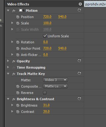

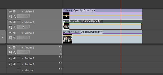

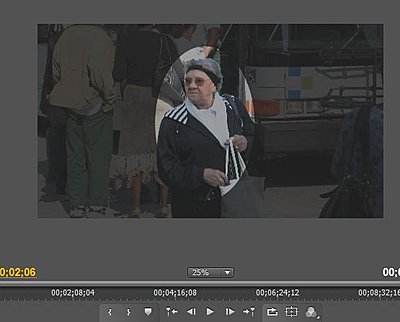

You can make the ellipse with the shape tool in the titler, and animate it using the travelling matte effect in PPro....use two copies of the clip, one darkened, one normal; matte the normal clip so only it shows up inside the ellipse, letting the darkend clip show through elsewhere...read about it here: Adobe Premiere Pro CS4 * Move or change the transparent area with Track Matte Key /Battle Vaughan
PS: added some screen grabs to show you the setup; in the fx window for the track you are highlighting, use the title track as the matte and use matte luma in the setup. You can vary the background brightness and contrast to suit using brightness/contrast on the lower track. Your ellipse in the title is full white, what is white will show from the top track, what is not will be transparent and show the lower track. Click the stopwatch in the position and scale motion items to keyframe the ellipse as you need. It helps to make the field for the title larger than the field of the image so you can move it around. (select in viewer, click to get size box and just drag to the size you want) /bv
