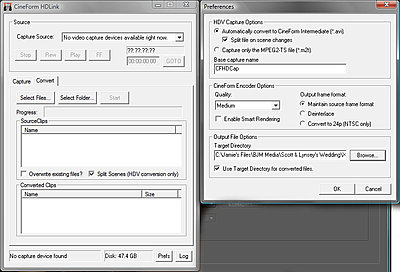

Thanks for the posts guys. Sorry for the delay in replying - have been away from my PC for the last week. I was just about to go through my whole workflow and post screen grab of all my settings. I'm starting to think however that it may be a problem with my cineform AVI files.
Below are the settings i used in Neo Scene to convert the .m2ts files from my XR500E.
I've just gone back and checked the original cineform avi files that i converted with these settings (i.e. 'maintain source frame format') - when i play them in windows media player they look very 'flickery' as if it is flicking between frames or something. When i convert the original file again changing the 'Output frame format' option to 'Deinterlace' or 'Convert to 24p' the resulting files look much smoother in windows media player.
Do you think this is the source of the 'judder' problem in my final video? Should i de-interlace the m2ts files in Neo Scene before i edit in Premiere?
