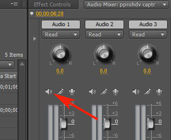

Suggest checking if you have hit the "toggle track" icon on the audio timeline, or the "mute track" in the audio mixer, see attached images....best wishes / Battle Vaughan

I very well might have hit the mute track in the audio mixer, still not sure exactly what happened, but pretty convinced it was something stupid on my part. I know the timeline mute was OK.
