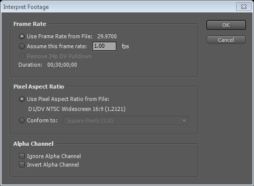

Where exactly in the 'interpret footage" dialog?
Right click on the clip in the bin > Interpret Footage gives me this box - see below. There is NO option to set field order.

Old March 18th, 2010, 08:34 AM   #6
Join Date: Mar 2005
Location: Neenah, WI
Posts: 547
What version of PPro are you using?
I'd say there could be two options here...
1. Try an uncompressed project (CS3) or sequence (CS4) and make it upper field dominant, 720x480, then try to reverse the field order on the DV footage...leave the MPEG2 stuff.
2. Make a project or sequence that is progressive...then bring in the footage and interpret it and see if at least it all appears the same and doesn't look odd, even though you won't have the silky fluidness of interlace...
I'm sure there are more options, these are the first two that come to mind for me...
