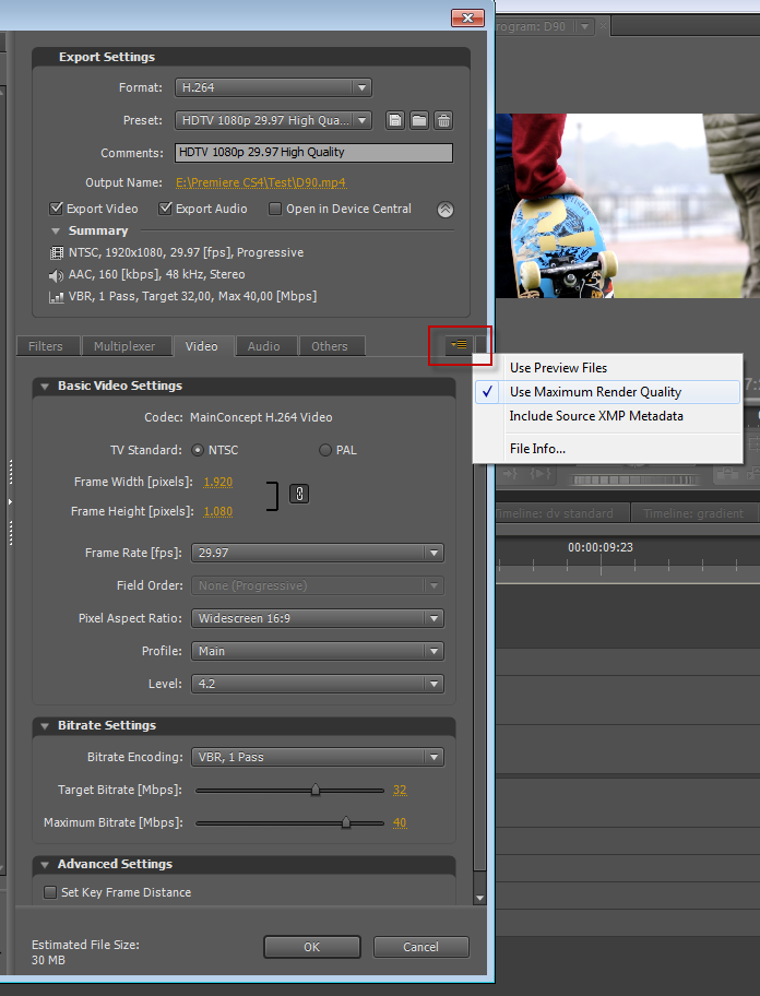

Did you set it to Maximum Render Quality? Its in that little dropdown menu on the right.
Or choose the HDTV 1080p preset.
Or have a look at wmvHD 720p, gives excellent quality.

I don't see a maximum render quality dropdown -- at least not on the Export Settings pop-up. Or is it on some other page?
The HDTV 1080p presets all seem to be for TV frame rates (29.97 as opposed to 30, which is what the camera actually used and what computers seem to want to see -- when I try this quicktime chokes on it, stutters up a storm, while it runs actual 30p just fine, but there's no preset for HDTV 1080/30p).
EDIT: Mea culpa. The camera documentation says it's recording at 30p. Premiere's metadata for the clip says it's at 29.97p. I've gotta go with Premiere on this one. Weirdly, when I've re-encoded this at 29.97, it plays just fine now.
What I'm currently trying is a custom preset based on the YouTube Widescreen HD preset:
format: H.264
Preset: YouTube Widescreen HD 1080 30p (<- my custom preset)
On the video tab:
tv standard: ntsc
framerate: 30
profile: high
level: 5.0
bit rate encoding: vbr 1 pass
target bit rate: 18
max bit rate: 24
What I get for this trouble is a fairly short rendering time (since the render isn't changing resolution or frame rate), a file that looks fine on my local computer using quicktime (well, there is some motion artifacting [woman talking with her hands, waving about], but the camera was running flat out at its maximum 24Mb/sec bit rate), and a file that YouTube uploads and processes like normal. But... YouTube makes available for viewing just an extremely compressed very low res version -- no 1080, or 720, or 480 version at all.
So... I'm now officially lost. Please help me overcome my cluelessness.

You need to be on version 4.2.1

Holy cats! I thought I'd looked everywhere. Didn't see that particular, um, button? Got it now, I'll give that a try. Thanks!
EDIT: Don't see any visual difference with this button checked. It did increase rendering time about 50% however.
