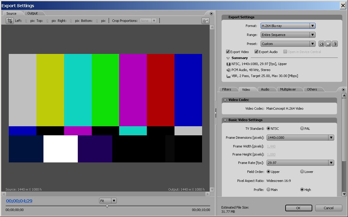

Here's the window I get when exporting to AME. Can you post yours?
Also, what happens if you just try "Export to Encore" from Premiere? I've had much better luck doing that than in going out via AME.
