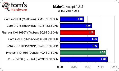

Harm, c'mon. The 6 core AMD is not 2 times slower than the i7 930. With both at stock speed, the AMD is finally able to keep up and actually overtake the 930 in some tests. However, the i7 has more headroom for overclocking; thus, it will be faster. Below is a test from tomshardware.com using the Mainconcept H264 encoder (I can't recall if they use Premiere Pro or the actual Mainconcept program for this test).
Many people here respect you (including me) and come to you for advice. This sounds like a 'fanboy' comment, and it does not help anyone.

If you are comparing the two CPUs with an equal number of cores, then yes, some tasks will take nearly 2 times slower on an AMD Phenom II processor than on an Intel i7 processor. And if a Phenom II x4 965 is about as fast as an average Intel Core 2 Quad in CS5, then don't expect the x6 1090T BE to be any faster than a stock-speed i7-930 in CS5.
And yes, the H.264 encoding tests use the actual MainConcept Reference AVC encoder. The Adobe front end favors Intel CPUs over AMD CPUs, however.
