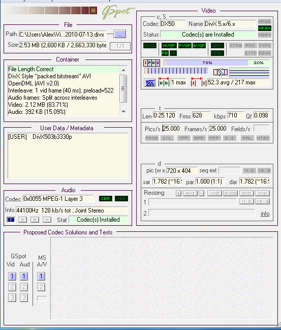

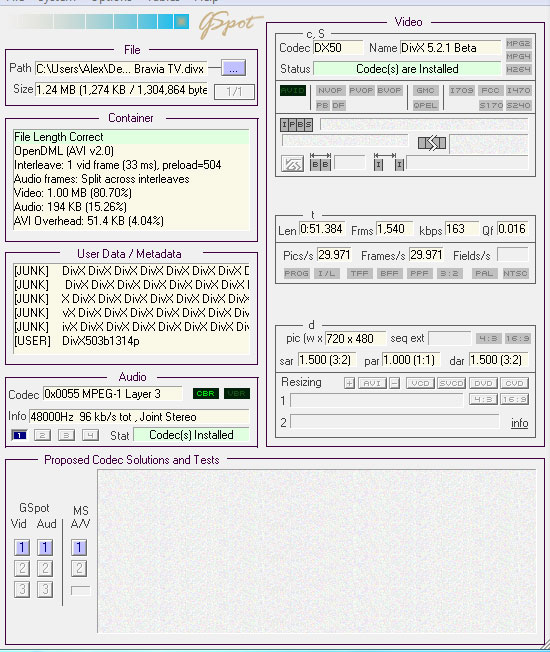

Thanks Harm. I have been trying that all day and still with no luck.
Whats weird is the test DivX file that comes with the TV does work ok. See comparisons of files from Gspot attached (one on left works, one on right does not). I will be peeved if it is because My divX is too new...

Hey your 'does not work' file is a weird resolution - 720x404??? That may not be the only problem, but it's almost certainly one of them. NTSC SD standard is 720x480.
Edit: also, the framerate of the working file is NTSC 29.97, and of the not-working file is PAL 25. The TV may handle both, but it's another something to consider. PAL SD resolution is 720x 576.

Not sure about the resolution. I just used the "Home Theatre" mode as advised by the chap at DivX (as I think it is the only one that makes a .divx file of the settings). Apart from that there are not really any settings to play with...

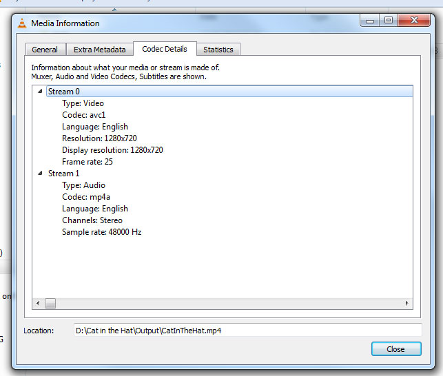

Just saw your edit and thought I would supply the spec of the original MPG4 that it "converted". See screenshot below

OK you are starting with 1280x720 25fps footage. So I recommend you select the H264BluRay 1280x720 25fps template in CS5 and export to that, selecting .TS muxing. Then import that into multiAVCHD.
If that fails, try exporting to the MPEG 2 BluRay 1280x720 25fps, again selecting TS muxing, and see if the camera can recognise that file standalone.
As an aside, even if you did get those DiVX settings working, you are squishing your nice HD footage down to puny sub-SD resolution and it will look nasty on an HD TV!
