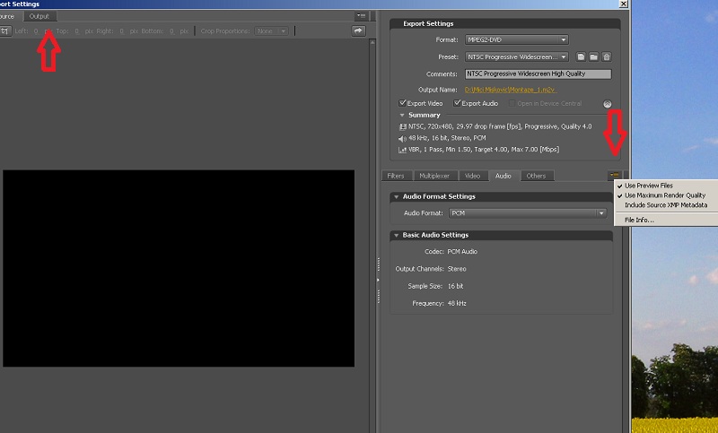

I think you've made a mistake within the Encore project, and inadvertently setup for a BluRay output.
There's no other way to explain this...
Before anybody tells you what to do, and what buttons to press, you need to understand the problems with downconverting HDV 60i...It can't be done properly without a proper deinterlacing method..
There's many ways to do it...VirtualDub and AVISynth, are the best freeware options out there..
I'm not sure, but allow Cineform to try the deinterlacing upon capture, or when converting to Cineform, try their deinterlacer.
Otherwise, Premiere's deinterlacer bites the bullet...
That being said, simply go to the proper output module in AME and output for High Quality DVD Widescreen.
Go to the top left tab, and click "Output"..This will give you a visual on the way it should look...
If this is too much to swallow, go to the secret flyout menu in AME, and click this button....
It should do a better job of resizing...But do a sample first..
Good luck!!!
BTW, i shoot HDV 30P..It provides great downconverting, and AME scales it down correctly.
Plus it's perfect for web viewing...

If one is planning on making a dvd from interlaced hdv with just Premiere.
Leave everything interlaced.
Set AME to mpeg-2 dvd upper 2.8/7/9 VBR2.
Just set it to max render quality and do not use Preview Files.
