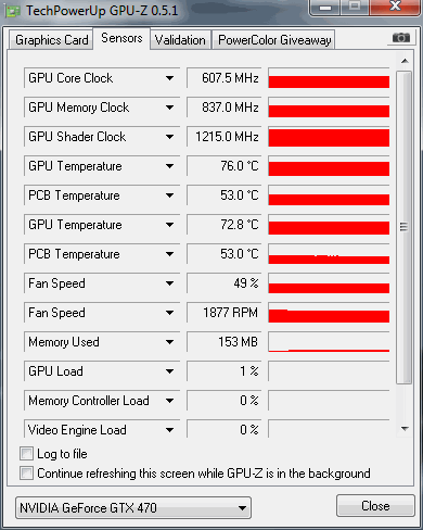

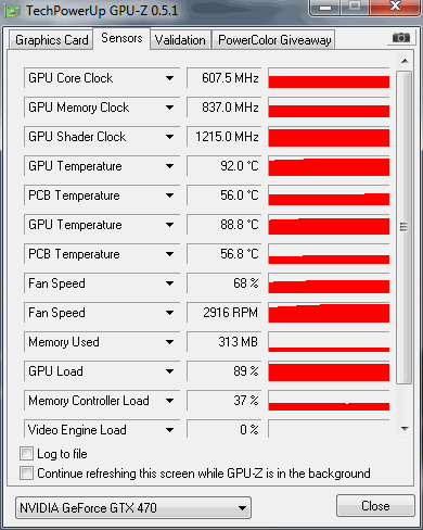

I further investgate this issue(using PPBM's h.264 project) and below i what I gathered addtionally.
With MRQ OFF: About the same performance between export and queue.
Export - GPU load: 80-90%. Stable.
Queue - GPU load: 1-90%. Heavy fluctuation but it does not affect the encoding performance.
With MRQ ON: Export is 2.8x faster than Queue
Queue - GPU load: 1-15%. Mid-heavy fluctuation.

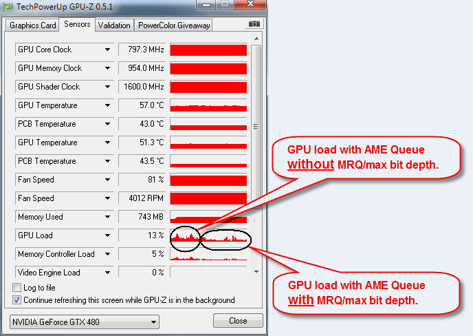

One of the explanations I heard is that direct export uses CUDA for all scaling and other processing that max render quality could affect. There are some cases where queuing to AME does not, and there is an unaccelerated software scale in AME after the GPU accelerated render in PProHeadless. This software scale will be affected by max render quality. Adobe is aware of this limitation and working on a solution.
The following graphs show the GPU load with different export settings, direct export without MRQ, direct export with MRQ and both situations using AME.
Export vs. Queue. Great difference in performance??-export-mrq.gif   Export vs. Queue. Great difference in performance??-export-mrq.gif

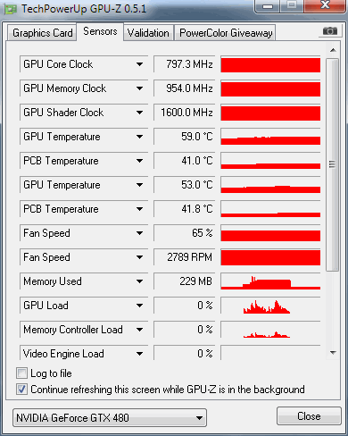

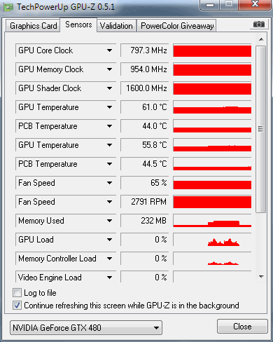

Here are my results of my testing (in transcoding a 1920x1080/59.94i AVCHD clip to a 720x480/59.94i widescreen MPEG-2 DVD-compatible file (the first graph is queued without MRQ, the second graph is queued with MRQ, the third graph is exported without MRQ (I did not bother to graph "exported with MRQ" because the GPU utilization results are the same as exported without MRQ)):
Export vs. Queue. Great difference in performance??-queue_mrqoff.gif   Export vs. Queue. Great difference in performance??-queue_mrqon.gif

The graphs in my post above clearly showed that in a simple AVCHD-to-MPEG-2 SD transcode, the direct export used nearly 90% of the GPU's power whereas AME queuing barely used the GPU at all. And for some strange reason GPU utilization is even lower with MRQ on than with MRQ off. No wonder why my HD-to-SD transcodes are slower in queued mode with MRQ turned on than in direct export mode. It might be an issue with the graphics driver or the driver's settings.
I retested with both MRQ and maximum bit depth turned on. No change in my results from the graphs above.
By the way, my results are with only one layer and one video source. Throw in multiple effects, multiple layers and multiple video sources at varying resolutions, and the results will begin to favor queued performance (or put it this way, the direct export performance will begin to approach that of the queued performance with both MRQ on and at maximum bit depth.
