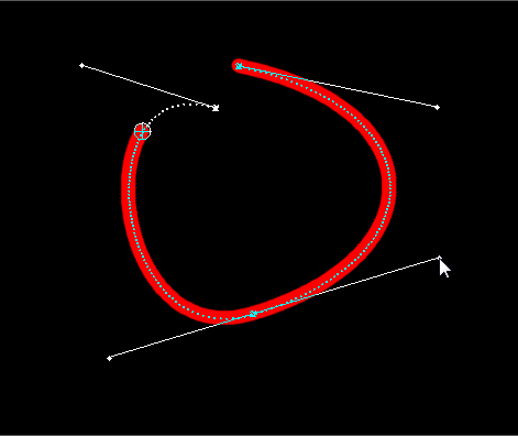

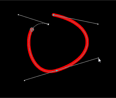

Use keyframes, in the Program Window you will have Bezier handles.

Old March 19th, 2011, 05:21 AM   #15
Location: The Netherlands
Posts: 710
Re: Question on Tutorials
http://www.dvinfo.net/forum/attachme...1&d=1300533671
