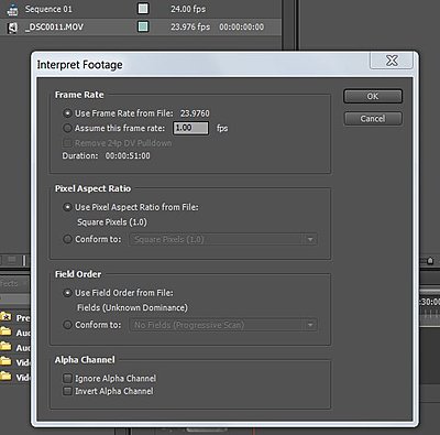

Right click on the clip name in the project browser, select Interpret Footage, set fields and other stuff to suit...
