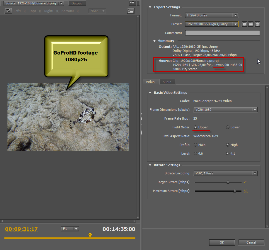

When DL has transfered the footage to Encore look at the source in the Edit Quality Presets.
DL has reversed the fields. HDV has become lower field.
When you do this with progressive footage like my GoProHD it becomes lower, when burning this to BluRay it gets reversed to upper.
http://www.dvinfo.net/forum/attachme...1&d=1303511945
