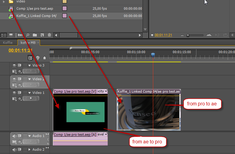

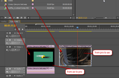

Just for testing.
Fire up AE and make a composition.
Open and excisting Pro project and import this composition.
Go back to AE and make some changes to this comp and go back to Pro and you will see this updated instantly in Pro.
Now you have another clip in Pro you want to do some stuff to it in AE then right mouse click and choose Replace with AE composition.
This clip will open in the AE comp already openend.
Make some changes to this clip and you will see it is updated instantly in Pro.
That is two way Dynamic Link.
You cannot do this in previous versions as it would reply with DL allready busy or something like that.
PPro / AE / Encore project communication-ae-pro-vv.png

As Ann illustrated and I described yesterday, Dynamic Link goes one way for a given instance, but if you are using unique assets to make sure no sequences, comps, or clips -- even if nested -- are trying to make a round trip that would result in an endless loop (in which case the DL with the circular reference is error trapped and simply won't work), DL has functionality in both directions. Several versions back, I believe it was only one way. Can't even remember any more but I think an AE comp could be put into PPro, but not the other direction way back when.
Use File > Dynamic Link... to get the following capabilities:
- a Sequence from PPro becomes a Comp within an AE project
- a clip from the PPro project panel becomes an asset in an AE project
- an AE Comp becomes a Sequence within a By two way
