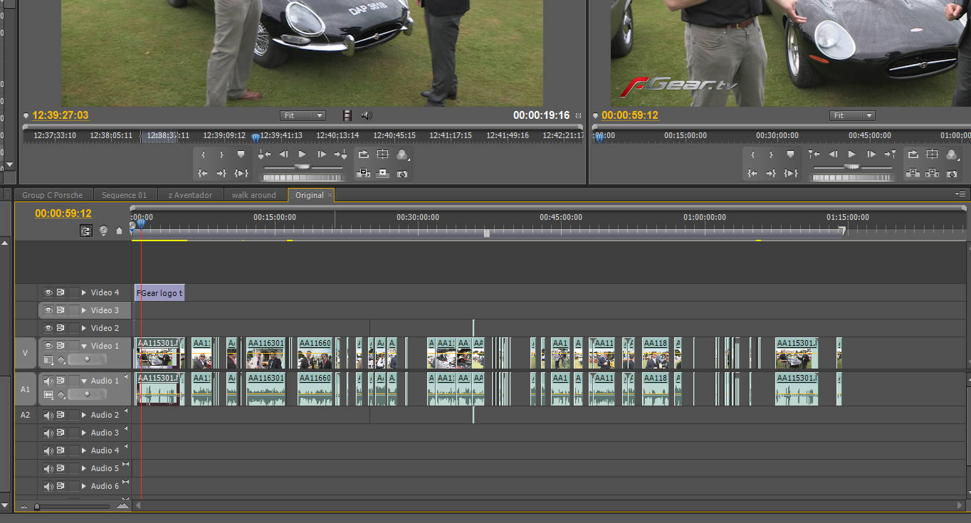

I've got some footage where we used two wireless mics for audio.
The raw footage plays okay in Premiere with both voices equally loud.
When viewed in the timeline, one of the channels seems to be at 50% or less in volume.
Anyone know what's happened and how I can fix it?

A screendump of the timeline would help.

here you go
At a glance it seems that you are a keyboard driven editor, right? :)
Your clips has two channels, but you have only one channel on the Timeline because the A2 and Audio 2 are not highlighted in the Track Header. When A2 and Audio 2 not is highlighted you loose the second audio track when doing Overwrites or Inserts with the keyboard. (Two audio tracks is louder than one. Assuming that they have the same content though...)

Hey Sayeed.....
Looks like you've only got one mono channel running..
Assuming you've captured true stereo to your file, you'll need to split out the audio before dumping onto the timeline...
I'm on CS4, so I need to highlight the file in the source bin, and go to Clip>Audio options>Break out to mono.
Drop the two mono tracks down....

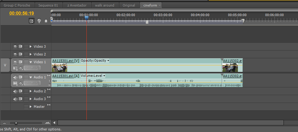

It's all rather strange. I've noticed that another clip in the timeline has the same problem, but the majority of the clips are ok. All were recoded in the same way with two separate mic's on two channels (Canon XF300)
Did a few experiments last night. Created a new sequence and a new project and imported the files again and it was the same problem.
However, converted the MXF files to cineform files and it all works ok. Even if I import the sequence into the original timeline.
So I'm thinking perhaps it's another MXF issue?
Screenshot of the clip with full working audio.
