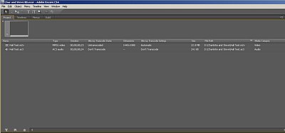

I just tried creating a short "MPEG-2 for Blu-ray" clip and imported it into Encore CS5, and sure enough, it did say "Untranscoded". This had me confused for a minute, but then I expanded the window farther to the right to show more columns, and under the "Blu-ray Transcode Settings" column, it does say "Don't Transcode".
Is it possible that like me, you were just seeing just part of the available data? When you build a disc, does it actually that it's transcoding the video in the progress window? This would take quite a while and you'd notice it. So I'm asking, how do you know that it is transcoding your files again?

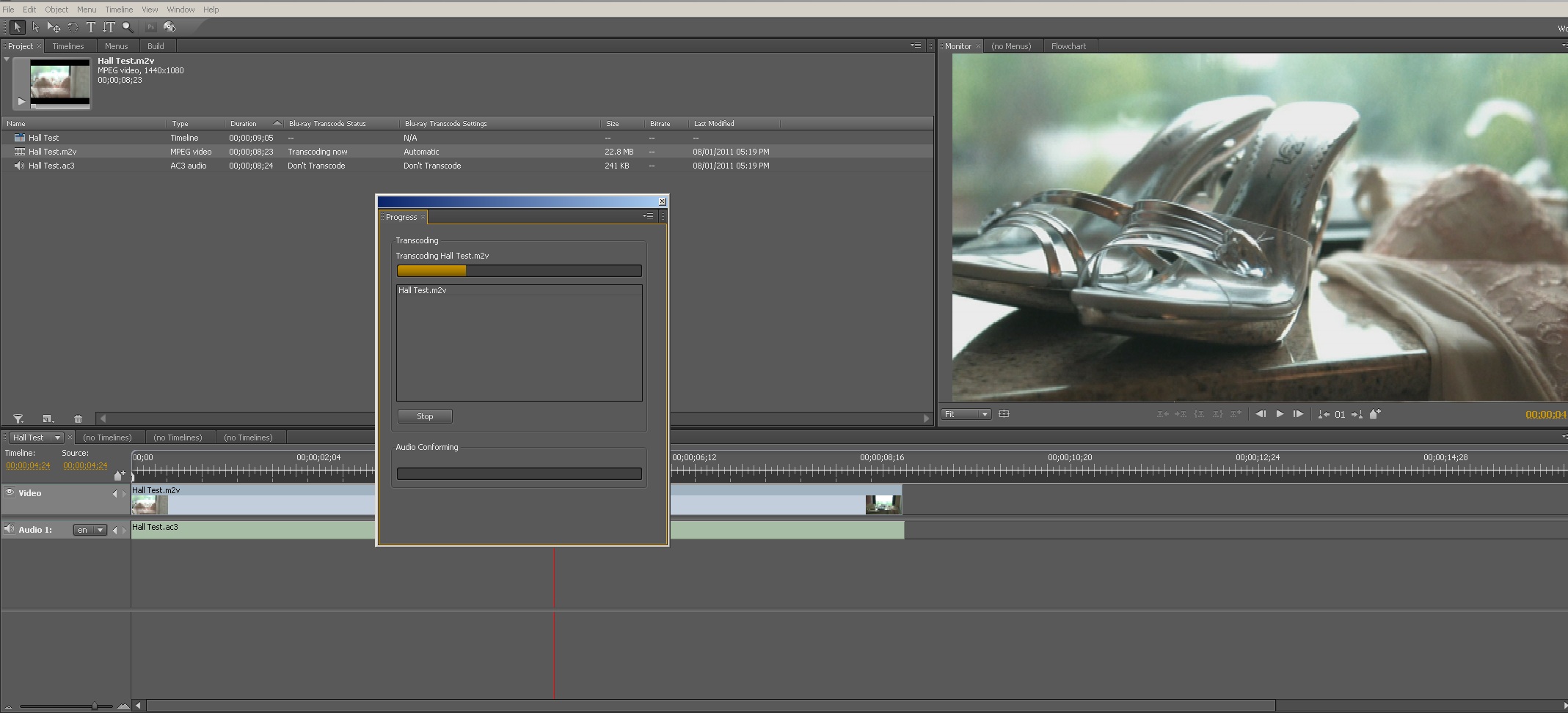

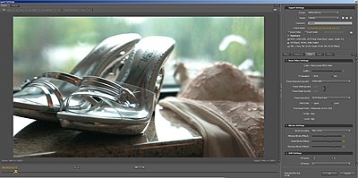

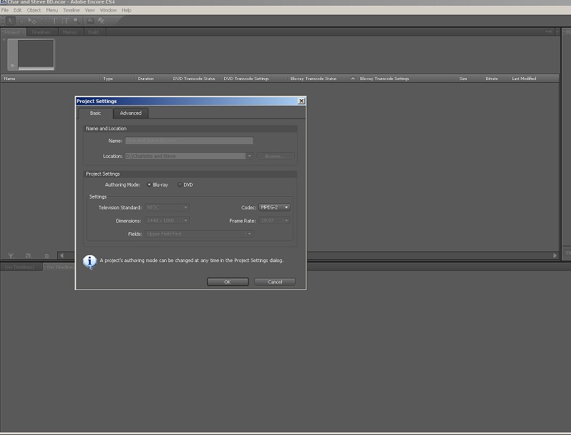

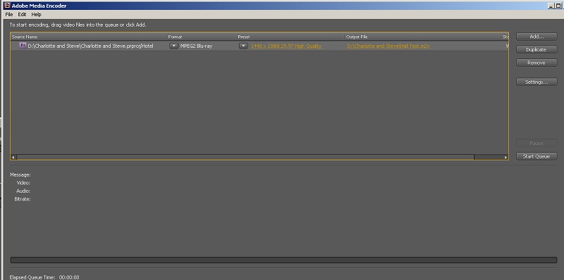

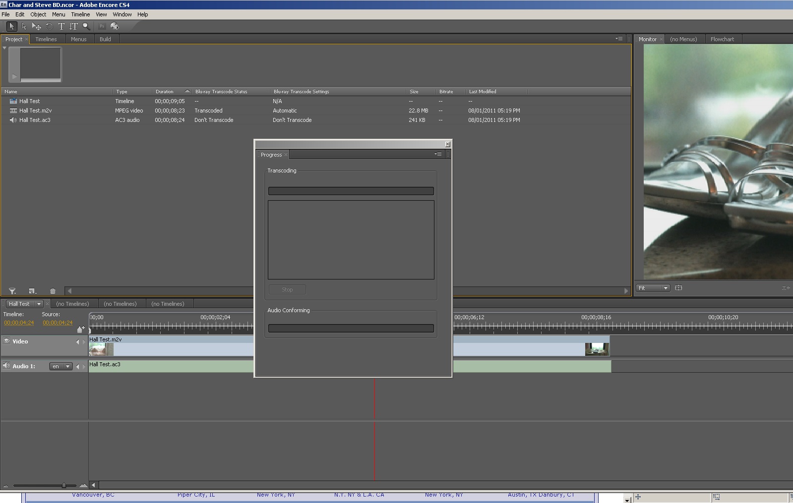

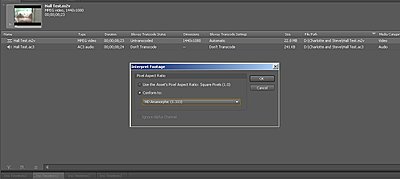

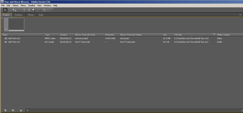

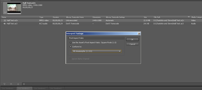

Okay, i did a few screen captures....
I'll upload as many as i can...
Encore headaches-ame-interface.jpg   Encore headaches-ame-interface-encoding-options.jpg
Encore headaches-encore-project-settings.jpg   Encore headaches-encore-bin.jpg

Except for encoding to DD 224kbps, the settings were untouched...
When the transcode happens, i verify the file by digging deep into the Sources>Transcodes> and see the .m2v, and xmpses and .xmp files...
Just to let you know, i can grab the transcoded .m2v file, stick it in a new project, and it will do a transcode once again...
This is puzzling...
Unless there's something obvious, i'm perplexed...
Again...Not an issue with H.264 files..But Mpeg2 is much speedier, and since my output is typically 1.5 hours, the BluRay gets fully burned..

try exporting to 1920x1080.
What i find odd is that you have to interprete the footage to 1.33 and
the video does not have exact the same amout of frames as the audio.

Yes, i found it strange to interperate the footage also..But every other .m2v after that gets interpereted correctly..Good catch Ann...
In fact, i tried exporting as 1920x1080, and using the project settings as such..
I've tried every possible combination of AME preset, with Encore's project settings...It's like playing "whack a mole".
As far as frames go, i can't explain it...Perhaps it's due to the fact that the GOP needed to close, at a different point to the audio..

Sorry I lost track of this thread and just discovered it again. According to the screen grabs that were posted, all settings look correct so it does look there it may have been a glitch in CS4.
I just tested CS5.5, exporting MPEG-2 for Blu-ray at 1440x1080i 29.97 and imported the resulting .m2v and .wav files into Encore and it says "Don't Transcode" for the video, so looks like all is well with the current version at least
