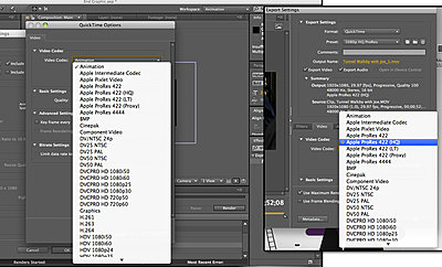

I dont know what to tell you guys... You can export ProRes from ANY of the Adobe applications with the above trick I mentioned.
Shot on the left is my after effects, shot on the right is my media encoder (where premiere sends all its projects).
ProRes 422/HQ + Premeire-proresexport.jpg
Justin Molush is offline   Reply With Quote
But only on a Mac!
