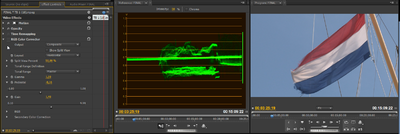

In the RGB color correction you will find the Pedestal for the blacks and the Gain for the whites.
Use the YC waveform to max them both out. This will give you nice colours.
Before and after.
http://www.dvinfo.net/forum/attachme...1&d=1315860957

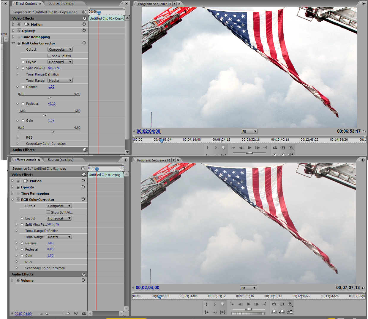

I was able to acheive a similar look. However, I am not sure i did it the way you described.
Here are my setting's.
Basically, I just keyed in your same Pedastal and Gain Numbers and got the same results. However, I am interested in understanding what you meant by "Using the YC Waveform and maxing them out".
Also, How do I know if I am on the Blacks and Whites for the Pedstal and Gain?
I am confused a little. (But my flags look better)
