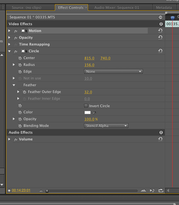

Thank you Landan. Just been playing around some more while you posted and the Circle filter (for example) enables me to do what I was wanting. Example screen shot of the effect and some setting options below - just in case anybody finds this thread in the future and is wondering about options to do this! Doh!, I knew there must be a REALLY simple and fast way!
Thanks again!

The circle effect will only give a circle mask. Wonder why its called the circle ;-)
But what if you want a different shape?
Place clip in track 1 and 2, superimposed.
Draw your shape in the Titler with e.g. the Pentool and make it pure white. Set it to Filled Bezier.
Drop this title superimposed over the top clip.
Add Fast/Gaussian Blur to it for feather. The Edge Feather only does the edges of a whole frame.
Add Track Matte effect to track 2 and set it to track 3.
Add desired effect to track 2.
Done
