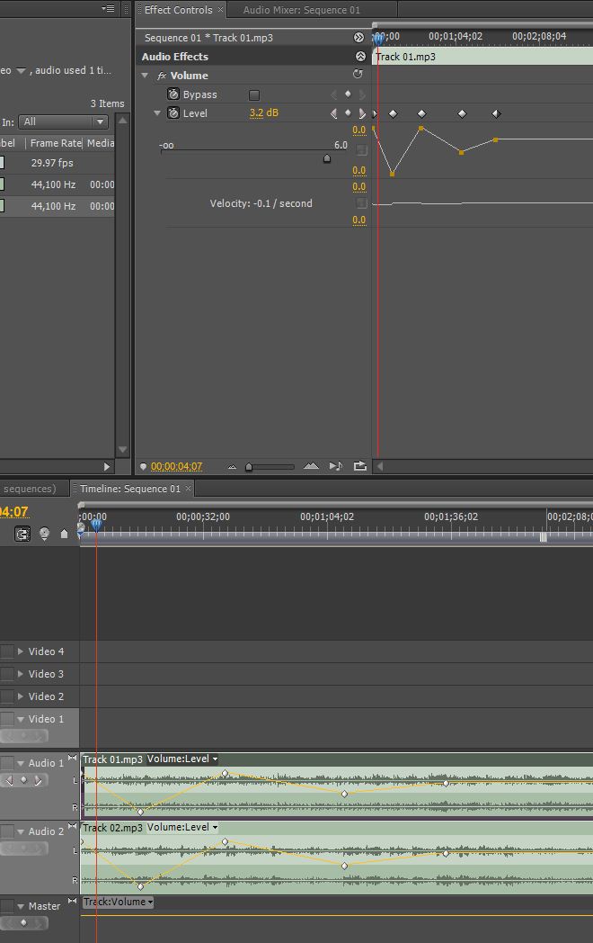

(later) Made a quick stab at this, and like you, not finding how to copy track keyframes crated by audio mixer. However, in effects panel, keyframes there are easily copied from one effects panel to another. Be sure you are showing clip keyframes for this (right click in audio track header, select show clip keyframes ) see attached jpeg.
I could copy keyframes from the mixer on a given track and paste them elsewhere on the same track (which doesn't sound useful) but like you, can't seem to make them copy to another track, although with identical specs and identical track setup --e.g., both showing track keyframes, both showing volume. The instructions in the help file aren't real clear on this point, maybe I'm missing something.
Bottom line is, I think, the easy way for you to do what you want is to apply your keyframes in the effects panel, per clip, and copy them to your other clips one at a time. That's the best I can do, I hope someone else will weigh in, I'd like to hear some more information....
