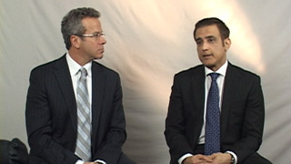

How would you fix an ugly blown-out spot on a background?
I am trying to fix a horrible production lighting problem in post. Sometimes good intentions create colossal headaches in post, and this one is a dandy. How it got that way is another story. What I got was a blown-out spot that looks... well, awful.
Now I am trying to fix the offending areas in post. I have had the most success using 3-way Color Corrector to highlight the offending areas and drag down the brightness. But, I'm not quite where I want to be, as I get color gradients with banding.
Any ideas would be appreciated. The footage is DV, and I have CS5 to work with. Thanks in advance.

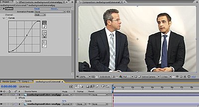

Hi Ray. This was done in After Effects (which you don't say if you have) though you may be able to do it in Premiere with blending modes? Basically use two layers, upper layer set to Screen Mode, add a Curves Adjustment and set the layer's opacity down. The jpg was very low quality, but this should give you the idea.

I have AE, but am not up to speed on it yet. Perhaps this is a good time to give it a try. The preliminary results look promising!

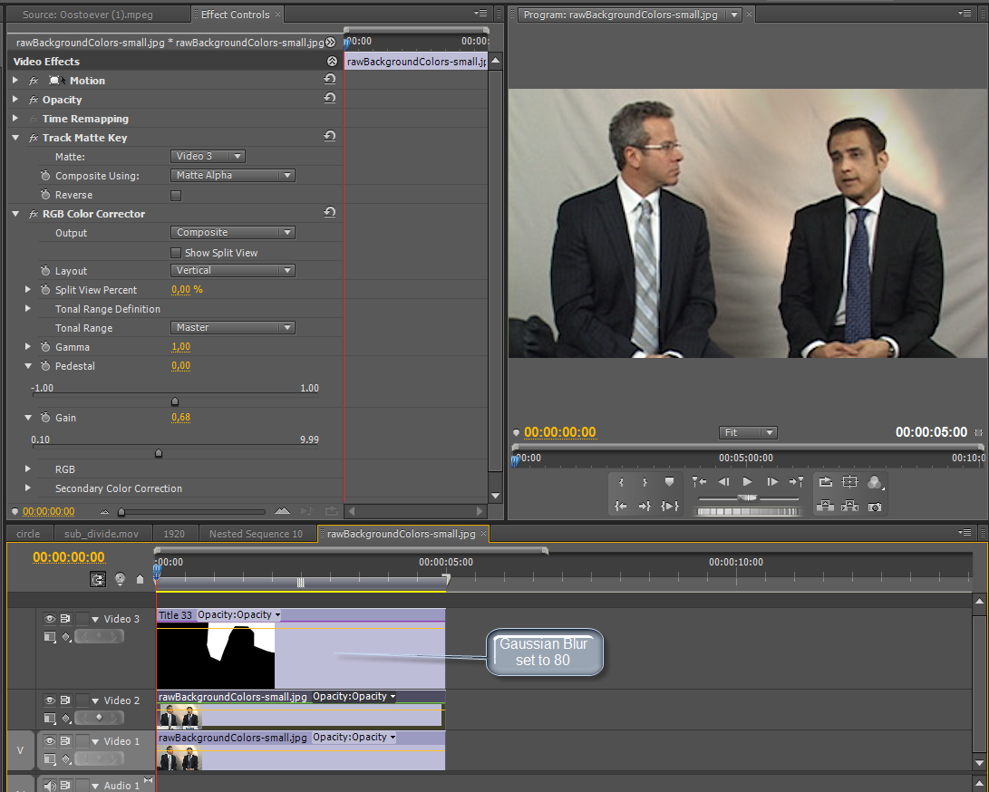

Try this:
Instead of using the titler you can drop a garbage matte on a white color matte and animate if nessecary

Your results with the titler looks quite good. I will also experiment with that technique. Since I have a lot of footage to fix, I will evaluate the trade off between time and results.
