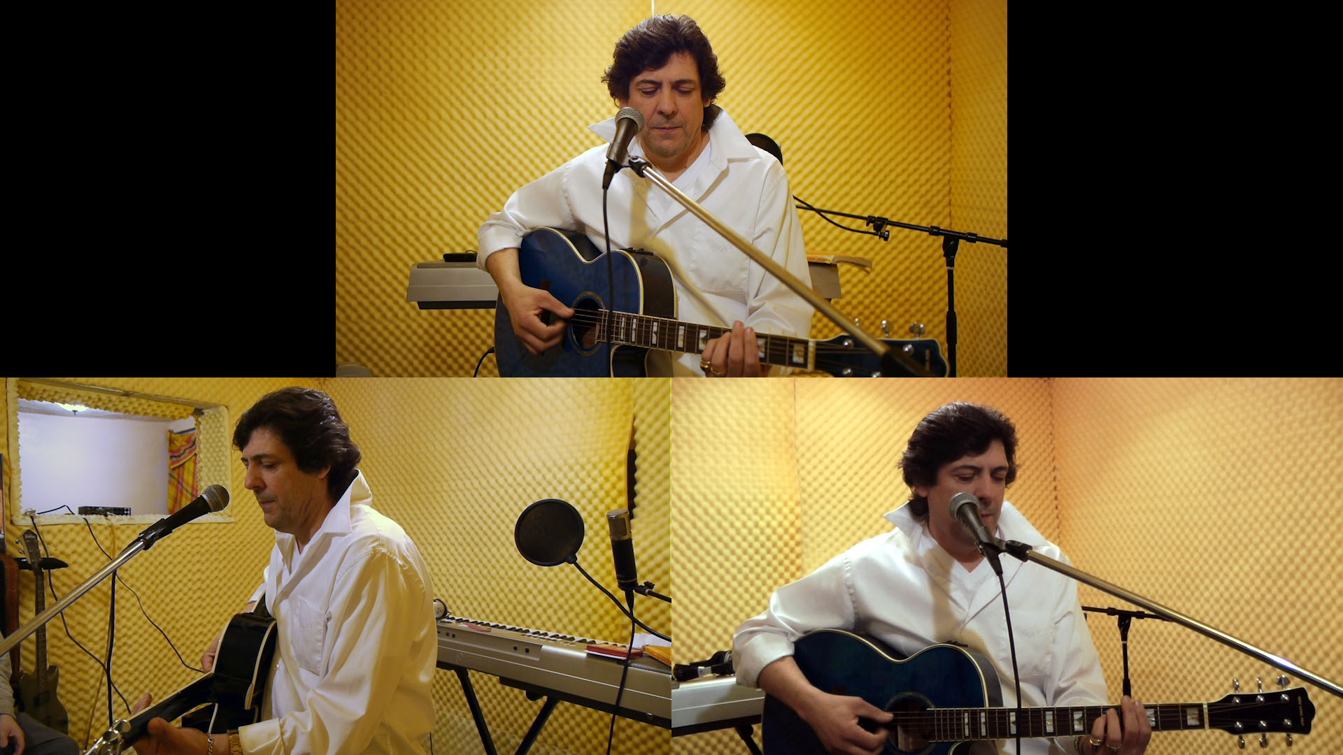

This is a Final Cut X tutorial on Multi cam editing and from 4:31 to 4:38, he talks about making the colors of 1 clip look like another clip. How do I do something similar in Premiere CS5? I'm editing a multi cam music video with 3 cameras and the colors of 1 angle is a little different from the others. Color correcting helps a little but still not perfect.
Here is a screen capture with the 3 angles. It's the one on the lower right that I'm trying to match to the rest. It looks better with some color correction but I'm showing that angle without any correction in case someone has some advice without loosing any noticeable detail at all.

Reduce the magenta by adding green.

Here is a corrected version using RGB curves. You may want to experiment with those as a starter

Use the White shirt as your color balance basis.
Either stick with the white shirt white balance in the camera angle you like or white balance it.
Then "Copy" that corrected shot, Select all the other shots, right click on one of these Selected shots and "Paste Attributes".
There are other ways, but this is the fastest I think.
Since much of the shot consists of that sound absorption foam, you could use that for some cool keying or blending effects to liven up the video - just a thought.

I ended up getting it to match even more that what you'll see but for some reason I decided to keep the settings in which I fooled around a little too much. It's sort of a unique look and it doesn't seam like the different picture in each camera is that too detracting anyway. You do notice a little detail lost though.
The original screen capture I showed only had the 2 tripod camcorders color corrected except for the camcorder shot in the lower right.
The video end up being good enough to put online and I have better ideas next time.
