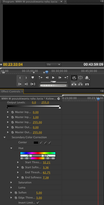

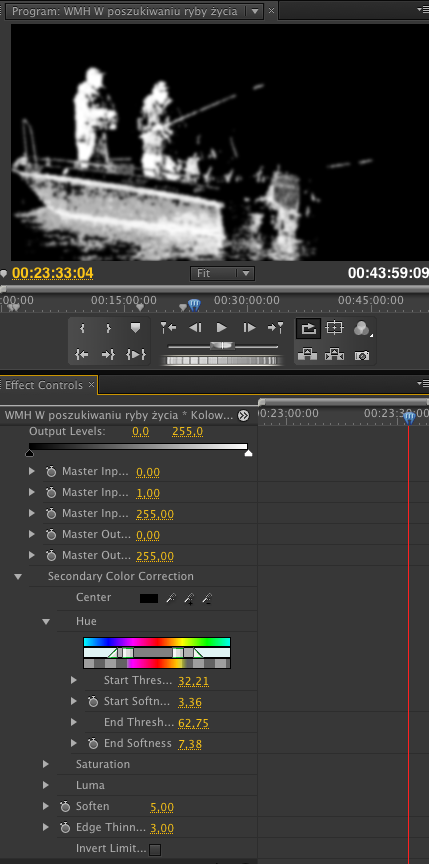

Each secondary color correction set (for example in Three-Way CC) has at the end the option to "Invert Limit Color" (invert mask). However it does not work for me - instead of inverted selection, I get only 100% black in mask view, and no color adjustment whatsoever.
Has anyone else run into similar problems? I'm trying to establish if this is a bug, or there's something wrong with my setup.

Of course. And I did make the selection as well. Normal mask is fine, it's just when I click "Invert..." I get all black mask and in composite view no color adjustment at all.

Perhaps the screenshots will better illustrate what I'm talking about. I know that mask is black and white, the problem is that when I click the button the mask disappears (is 100% black), instead of inverting.

Ah, now i see what you mean.
Perhaps a bug on the Mac version.
My output is normal.
