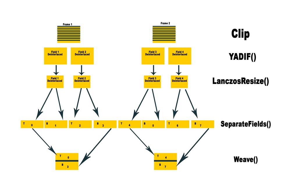

Eric hit it on the head....
The only way to do proper downconverts is with third party softwares (AVISynth)
Adobe needs to step up to the plate and take this issue more seriously..
Until there's a plugin to properly address field manipulation, deinterlacing, resizing and reweaving, nothing will come of Adobe's claim to "Better quality" downconverts.
Heck, i can live with some artifacting that Eric mentions, but Adobe hasn't addressed the issue of properly dealing with interlaced sources.
How does your deinterlaced Vdub transcodes look?
Here's an old drawing i made, just to verify one of the scripts i used years ago, to better understand how resizing interlaced materials work.

Sorry Bart, perhaps i'm not understanding better....
But to properly do a downconvert of interlaced material, you need to separate the fields, resize, and properly weave them back.
I used to run these programs, and it took forever..Just think of the processing power involved. Also, think of all the different deinterlacers, options, and parameters in each deinterlacer, and we can come to the conclusion that Adobe hasn't taken the issue seriously...
Resizing interlaced frames any other way is wrong.
Of course, progressive is a different story. It's a non-issue. Whether somebody chooses bilinear, bicubic, or bicuspid, is all personal preference.
But nonetheless, interlaced downrezzing and progressive downrezzing are different animals..
That's why i always film in 30P.
AME correctly scales and crops progressive material..
