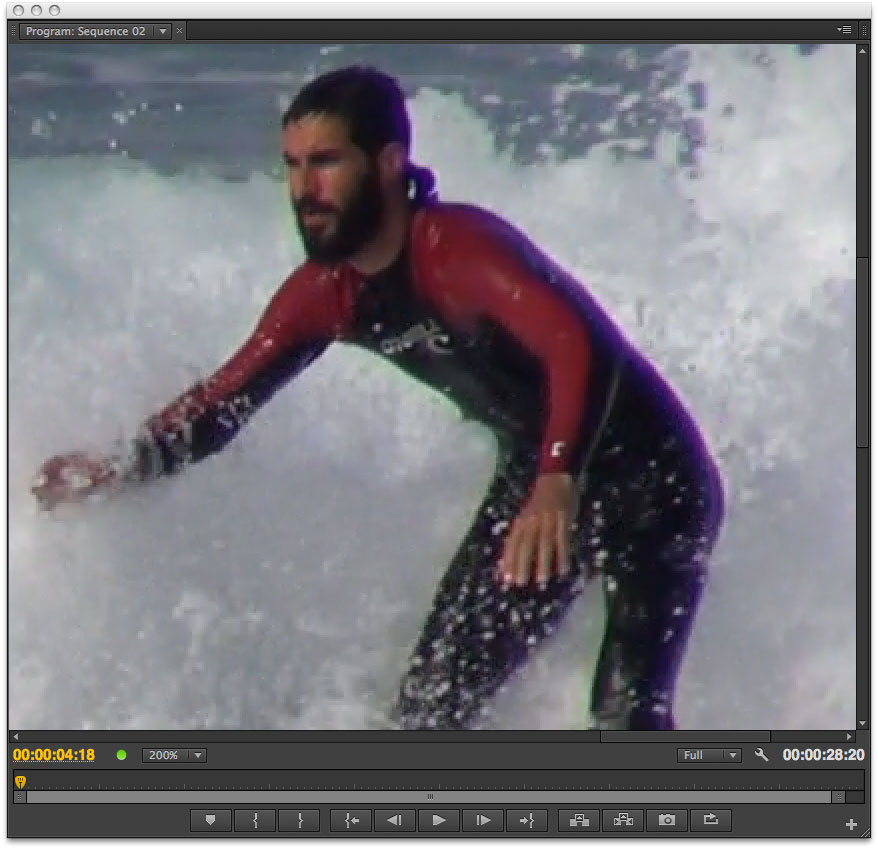

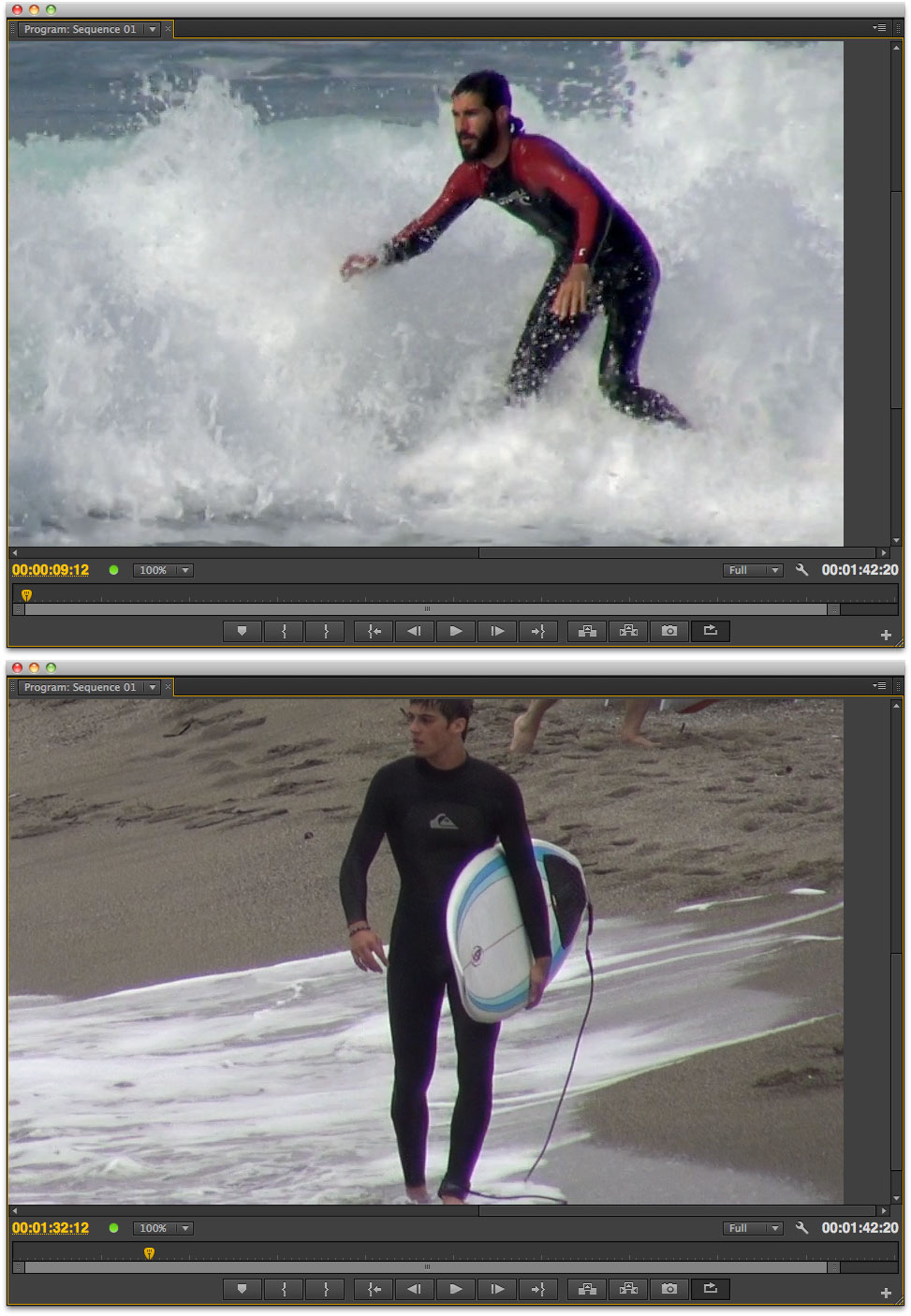

I bought a Sony CX760 for shooting surf, typically very contrasty scenes: white spray and boards, black wetsuits.
When I shoot from the beach with the zoom and also with the zoom conversion lens VCL-HG1737C I get nasty chromatic aberration all over the place. Very disappointed.
I still need to decide if I will keep the camera because I mainly want to shoot from in the water with the sportpack where it will all be wideangle, hopefully that will eliminate the problem.
Anyway I wanted to ask if there are any plugins or filter techniques to remove the CA in Adobe Premiere 6.
I find lots of tutorials for After Effects but of course would like to avoid trips to AE.

Yeah it's terrible. Looking more and more at my surf footage I start to see those damn green and purple fridging everywhere, even in my dreams, go figure.
Bah, I am seriously thinking about getting the VG20. The NXFS100 would be awsome but out of my budget.
Any tips on how to prevent/ reduce CA more than welcome...

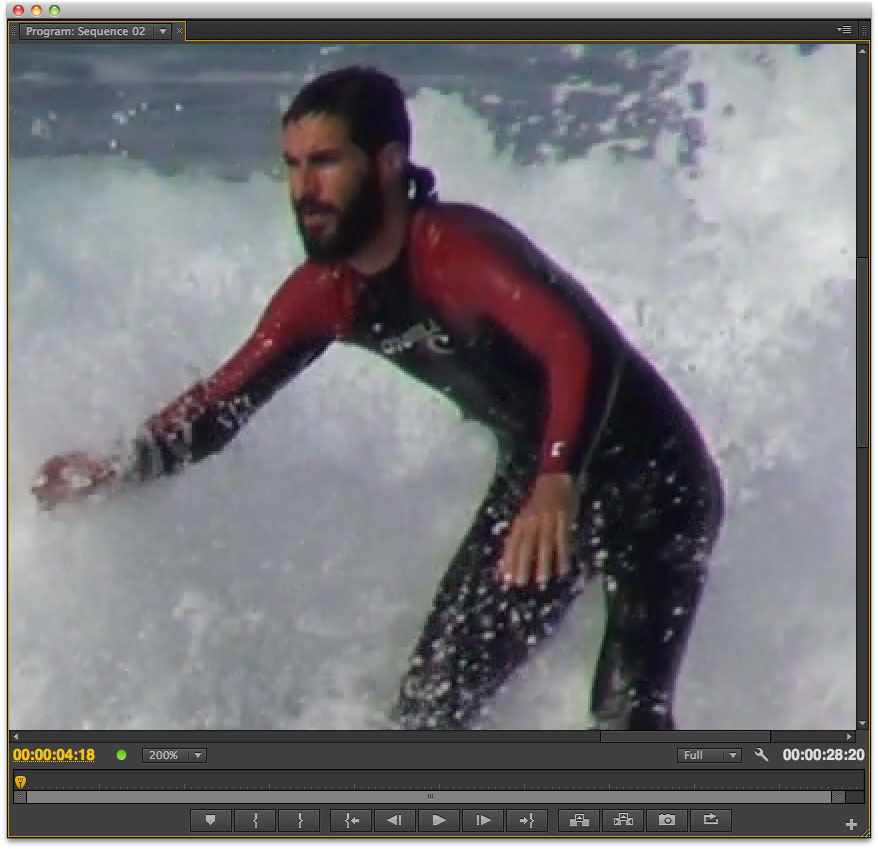

I tried it with my footage but unfortunately it looks like my CA is so severe I can't correct for it with the CA filters in Photoshop. I needed a much more fine tuned mask/ keyer.
Secondary color correction does the trick for me, after creating the mask and applying some blur I just lowered the saturation and came up with this. (Note that I did not correct yet for the greens)
Chromatic Aberration removal plugin or technique-ca2.jpg   Chromatic Aberration removal plugin or technique-ca2-corrected.jpg
