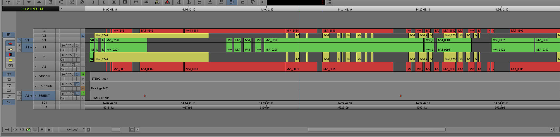

I have attached an image to show you how my timeline looks after the basic sync I described.
I think you have Case 1 correct, but I did try to do what you said, one thing I couldn't do is assign a timecode to the transparent clip, when I select modify the timecode option is greyed out.
also I tried grabbing a long clip with timecode and then grabbing the shorter clips on a 2nd video track but I could only syncronise one clip at a time, rather than highlighting all the short clips and syncing it in one go which is what Bart described.

Ah, sorry, you are right. Similar to DSLRs, the synthetic clips don't have embedded timecode. As best I can tell, there is no one-click way to synch these multiple clips from multiple cameras. It would be wonderful if all clips on a sequence could be aligned to the sequence timecode, but alas it is not so in CS6. BTW, it is a bit of a hidden feature, but you can change the starting timecode of the sequence by right-clicking the name of the sequence in the tab of the timeline window and selecting "Start time..."
The easiest work-around I can think of is to create a single file with timecode of a greater length than your projects will be. Perhaps Qtchange can do that; otherwise, I just verified that a sequence with nothing but a transparent clip could be exported to an MXF file with timecode. Once imported, the MXF file (or whatever file format you prefer that contains timecode) can have an opacity of zero if for any reason it needs to be on any track other than V1.
The kicker for projects like yours is that although you can synch clips from any number of tracks, only one clip per track can be selected at a time. Unless there is a trick that I'm not aware of, that means with many short clips on a given track you'd have to repeat the synching operation an equal number of times. Also, Premiere uses overlay when synching, so you have to be very cautious to not accidentally move a clip on top of another on the same track when doing the synch.
Again, sorry, but as best I can see, at this point there isn't a no-brainer way to do all that synching. I guess it gives the software engineers at Adobe something to work on for CS7, eh?
