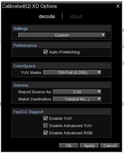

If you have installed a codec in PPro for your EX1 such as the XD codec from CalibratedQ, check the codec settings for YUV709 (full) instead of yuv709 (sempte) which clips at 16 and 235.
I don't think PPro does the clipping, I could be wrong, but I haven't found any setting that would do that.

(more) The YUV colorspace is defined as 16-235, if you are using a codec that converts to RGB space it can convert to full range. If you are working completely in YUV the conversion won't happen and you get the 16-235 that was recorded. That's my understanding, more info at http://www.calibratedsoftware.com. Even if you don't use this particular codec, the user info pdf posted with with their xd codec has a pretty good explanation.
