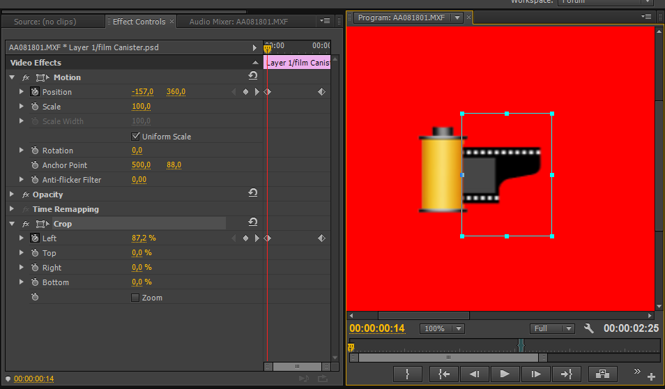

I have knocked up a 35mm film canister graphic in Photoshop, and a strip of 35mm film on separate layers to use as a fly in lower third. My problem is that I want the canister to be placed away from the left hand frame edge, and the film to appear as it is coming out of the canister. What happens, of course, is that the film strip starts out of frame. I want to blank the area left of the canister.
Now I know I could copy the clip below and place it above the lower third, and garbage matt out everything other than the tiny bit I'd need to blank the screen left of the canister, but is there a more elegant solution?

Hi Trevor. I would try adding Video Effects/Transition/Linear Wipe to the filmstrip and then keyframing the Transition Completion as it moves across.

Hi Gregory. I've just been thanking the guys over on the Adobe Premiere Pro forums, and a Linear Wipe was the best answer I got over there too.
Adobe Community: How to start lower third wipe in away from fram edge?
I've already tried it out, and it did the job nicely, and way nicer and less messy than using a garbage matt. Actually, I also mentioned that I was getting flicker because I am moving the hard edged graphics in big steps across the screen (12 frames for the full transition), and that I added motion blur to the clips for just the frames they are moving. But it has just occurred to me that I might be able to use the feather effect in Linear wipe.
OK. Just tried it and feather definitely makes for a smoother transition.

Glad it worked out for you, though what I intended was that you would keep your slide in from off screen, and that the Linear Wipe edge would be keyframed so as to remain "hidden" under the canister. It would have meant a bit of fiddling with the timing of the wipe but you would have been able to keep your shaped leading edge of the strip moving outward from the canister.

Gregory I think that's exactly what I ended up doing. One problem is that because I need to hide the left end of the film strip under the canister, and that the right end has a graphic representation of a leader, I can't adjust the length of the film strip other than by trimming in Photoshop and saving different versions at different lengths. Not a big deal though, although I am concerned that I will end up modifying the wrong version and find that I have inadvertently made the clip too short in another sequence.

I would make two layers: one for the canister and one for the strip
You only have to keyframe the strip with a crop (for the left side) and keyframe motion to make it move to the right.

Ann, that's a great idea! And it lets the leader travel across the screen as opposed to being revealed by the wipe. It also lets me use a one size fits all for the film strip.
One problem.
If I set the left crop point at the beginning and end of the strips motion, then the left side of the strip is creeping out from behind the canister. So I am having to manually adjust the left crop point ever few frames. (I can't see any way to adjust the anchor point, and am not entirely sure why this is happening.)
It is still a better option than using a linear wipe though.

The left edge will vary a little unless you get the crop percent exact on the keyframes at both ends of the sequence so that the left edge falls precisely in the same place at each end of the keyframing.
You might mask any slight variation by hiding the left edge under the overlaying cassette images so that it is obscured thereby....
