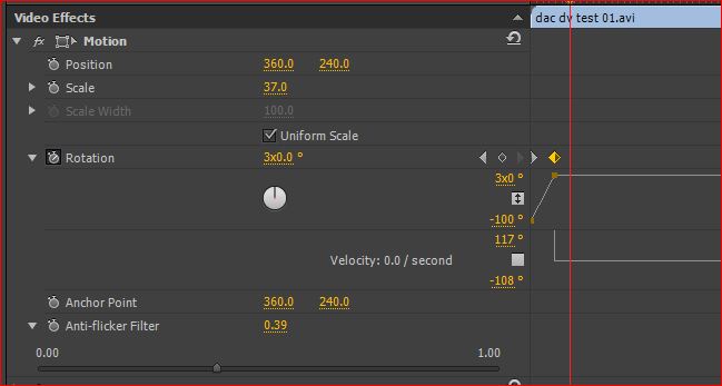

Ann is right, AE has lots more controls. If you want the image to rotate about its vertical axis, that's a job for AE. If you want it to whirl around (like the sample attached) it's pretty easy and you can do it in PPro effects.
Select the clip on the timeline, open effects, select scale to make image fit within the frame, if necessary.
Select rotation, click on the clock icon to set your first keyframe, move time selector to where you want the effect to end and move the roatation amount to however many rotations you want in that time. It will spin as fast--within reason--as you like in the time you give it. See attached jpeg and mpeg sample.
{edit} I completely forgot about video effect >transform>camera view, which does easily do the vertical spin (longitude) or on horizontal axis (latitude) or does the whirl thing (roll) even more easily than the above. It's in CS6, I don't know if it appears in other versions.

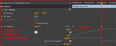

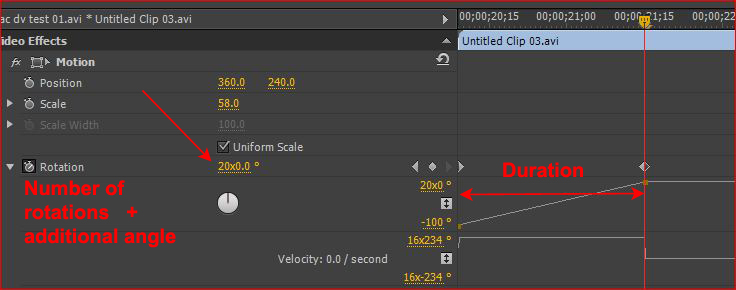

OK -- afaik you can type in any number of rotations, any degree of rotation,or any number of rotations plus a number of degrees in addition --- to, say, make the page end up at at 45 degree angle when it comes to rest. See the attached jpeg.
The rate of rotation is simply the duration of the rotations times the number of rotations ---- if you type in 20 rotations and your beginning and ending keyframes are one second apart (see jpeg) you get twenty rotations per second. If your keyframes are two seconds apart you would get ten rotations per second. If the keyframes are a half-second apart you would get an effective rate of 40 rotations per second, over a half-second duration.
PS: the video clip above is not the quality you should get, I arbitrarily sent it as NTSC mpeg2, which caused interlace combing. If you are working in wmv or mov this should look much smoother.
