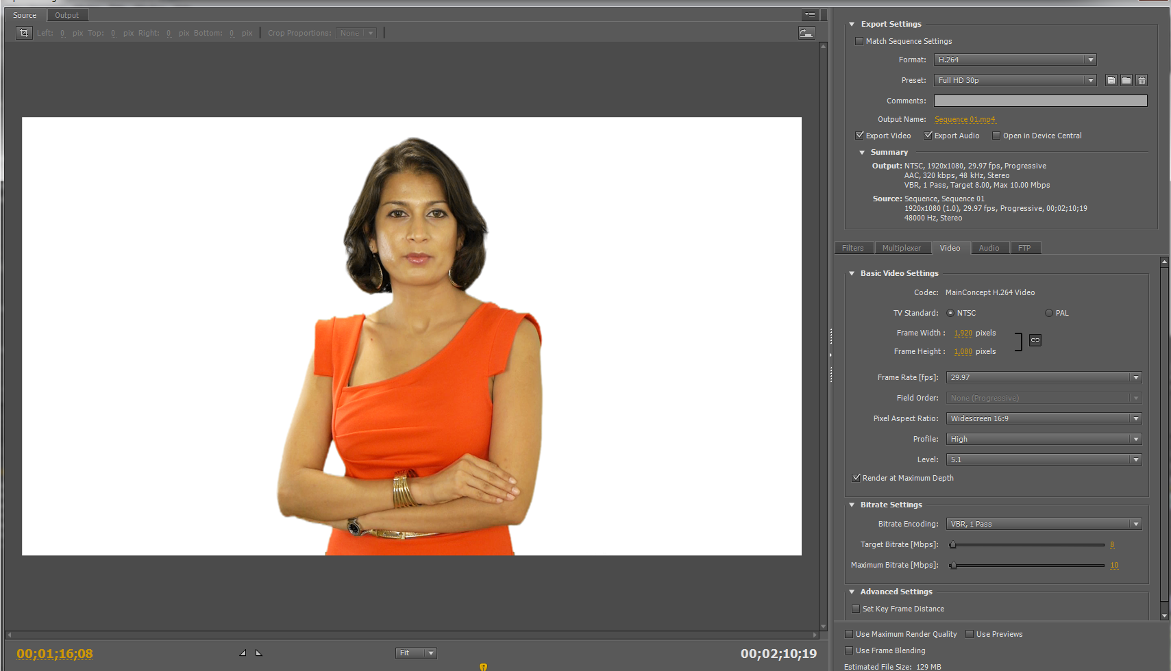

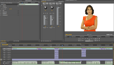

I'm having some sort of really weird issue. Here is the video:
After each graphic the speaker's voice starts out very quiet, and then jumps into the correct volume. If you view the attached screenshot I have no fades in the beginning of the audio. I also have the Volume Audio Effect button switched off so that nothing can affect the track's audio. The really weird thing is that the video/audio plays fine within Premiere. I also attached my render settings in case that's the culprit. Thanks!

I figured it out. It was the DeNoiser. I'm not sure why, but I changed the settings a little bit and moved it to the end of the FX chain.
