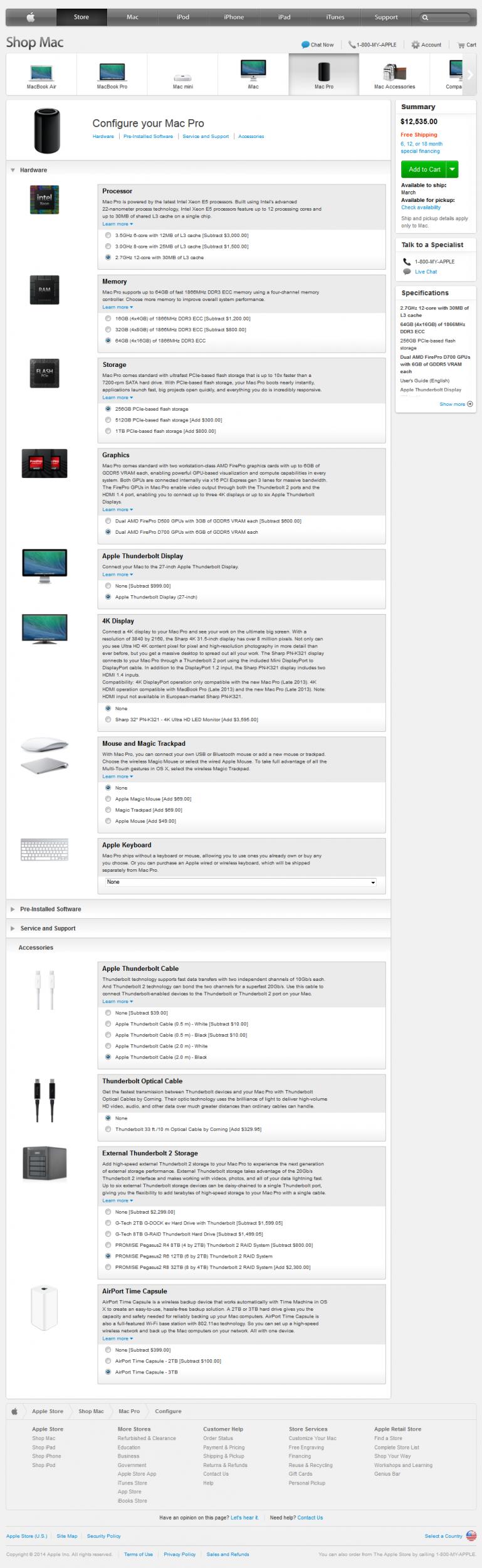

Now, without wanting to get into a PC-Mac war, I just looked over a potential 'Trashcan' MacPro configuration. The picture below shows what I have chosen and I have some serious doubts about that configuration. First of all, it is only a SINGLE CPU configuration, not a dual CPU. Secondly, it uses dual D700 FirePro cards, which do not yet measure up to a single GTX Titan for PR. Third, it uses a Thunderbolt 2.0 connection to the Promise R6 (6 by 2TB) which is limited to around 500 MB/s transfer rate. For comparison, the PC above achieves around 2500 MB/s with those SSD's. But even with these limitations, the price tag on the new MacPro is around $ 12.5K versus the much faster PC with a price tag of around $ 11K (with 48 logical cores instead of only 24, with double the L3 cache, with 5 times the transfer speed and faster video).
