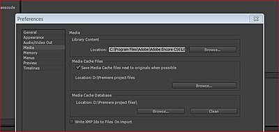

Did you do the link in preferences > media to the folder where you put the downloaded files?

Nope, different procedure: if you are on a pc, go to edit>preferences>media and in the box that opens, in the library content selection area, navigate to the folder in which you unzipped and stored your downloaded files. See the attachment...if you are on a Mac, follow the instructions in the Adobe help file I linked earlier.

If you want ALL the goodies for Encore, there is an extra download here - Library, title templates, template projects missing: Premiere Pro, After Effects, Encore
The top part is the standard download that you already did, and it doesn't appear to add anything, right? Scroll way down to the bottom of link, where it says "Additional solution: Install the Resource Central library content". Click on ENGLISH to download, and be sure to follow instructions at bottom. I believe the download is north of 3GB, and you need to unzip the contents, which results in another zipped file, unzip that and install. Just follow directions
