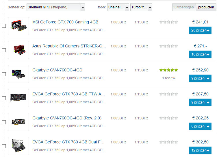

These are the cards I would consider and that are available over here with Dutch prices.
They are all 4 GB models but with a higher clock speed than the regular 760's, hence my choice for one of these. I personally am rather fond of the EVGA brand, but that does not imply the other brands are bad. In my opinion you should choose the highest clock speed first and then look at price/warranty ratio and finally at fan noise (although that is difficult to find out).

Can the EVGA cards be unlocked to work with the CUDA acceleration in PremierePro CS6?
Forgive me but I am very much a novice in this technology.

Yes, all of these cards can be used in PR with hardware MPE acceleration, including the EVGA's.
With a different interpretation of 'unlocked' you touch upon overclock ability of these cards. EVGA has a great utility, EVGA Precision X, to 'unlock' or overclock the video card.
