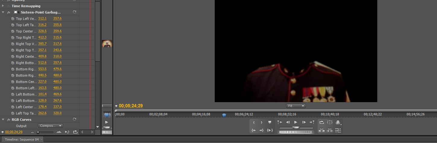

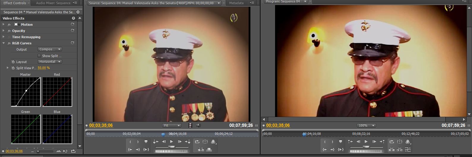

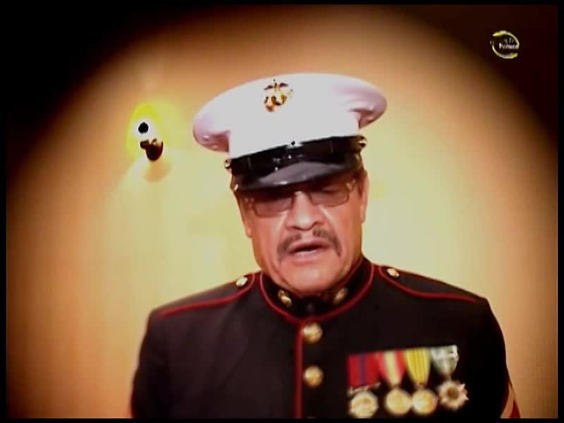

Here's what my suggested fix(s) look like.
One jpg is the before and after a simple curve adjustment to the blacks.
Second jpg shows what the overlay track with the black adjustment, blur and matte looks like. Everywhere it's black, outside the mask, the track below it shows through. (obviously, you make the same adjustment to the curves on both tracks so the hat, etc, are consistent with the level of the rest of the quartertones.)
The system wouldn't let me upload a video clip for some reason, so the last jpg is a still frame from the output. Obviously you can fine tune all the perameters to your liking, but here's one idea of how to repair this......
