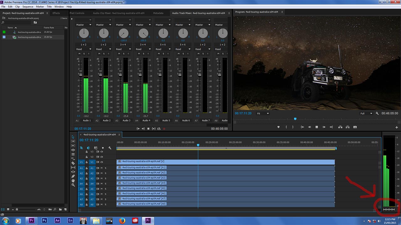

Just having some problem dealing with multi-track audio in Premiere CC. I am exporting to an 8-channel mix, and when I try to map my audio to output to anything other than track 1 & 2, I can no longer hear it in my headphones.
The desired audio output is 8 mono tracks (not 5.1 which I though might've been the problem if I'm listening through stereo headphones). I can see the levels in the meters so I know the audio is there. When I export my timeline and then play it back through Premiere or any other software, I can hear all the audio is there.
I just cannot figure out how to monitor audio within Premiere if it is mapped to output tracks 1-6.

Hi Vaughan, thanks for answering - yes that is what I've been doing:
New Sequence > Tracks > Multichannel > 8 tracks.
I'd see the 8 different output tracks in my meters, but anything mapped to tracks 1-6 just didn't come through the headphones or speakers.
Thankfully I've finally figured it out (i hope) after plenty of Googling and trial & error. I found plenty of tutorials about how to map multichannel audio, but none of them mentioned how to actually hear your results!
The answer is: the little icons under the meters have to be selected for each pair of tracks. If none are selected (the default), it plays only tracks 1 & 2. So to hear all tracks, I need to have all of these little icons selected (they'll turn blue when highlighted).
Strangely when testing this in CS6 as well (this project has been edited in CS6 but finalised in CC because we need to deliver DNxHD in a MXF wrapper) it will only let you select one pair of tracks at a time. So you can only monitor tracks 1 & 2, or tracks 3 & 4, but never all 4 at once. Looks like it's something they've since fixed in CC though.
John Wiley is offline   Reply With Quote

And as it turns out I haven't solved this yet after all - in the projects where it was causing a problem, the channel monitor toggle is simply not there. I can start a new sequence and set it up using the exact same process I used to achieve the screenshot above, but in certain projects there simply will not be any of those little toggles. Strange.
