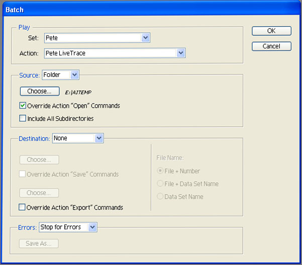

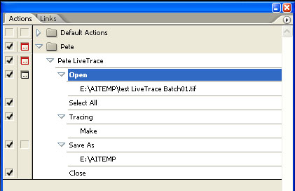

Ok, I'll attach jpg files of both the script with all the steps scrolled open and the Batch dialog settings.
I ran the same Action using a B&W default on 67 frames of 640x360 TIFs and the Action itself took about 1 second per frame to LiveTrace.

EDIT: You get to the Batch dialog from the little right-pointing caret in the upper right of the Action Pallet. You don't use Bridge at all.

Our Action scripts are similar, except that I exported as bmp, set a destination folder in batch, and did not override open, save, or export commands. Additionally, I find that after taking a test frame, tuning a live trace, and saving the setting, it is necessary to make that setting the default and make sure the swatch library is open before the batch executes.
It worked for me (once). Clearly, this is way preferable over converting 10 frames at a time in Bridge. However, I must be doing something wrong in an inconsistant way. Sometimes I get a dialog for every frame in Illustrator. Othertimes, PP shows it as a video of the correct length, yet only displays the first frame.

You're correct about needing to set the default for LiveTrace (and I suppose the color pallet, although I've left that at default myself) ahead of time. It appears that the Action Pallet only drills down to the menu item level; looks like whatever is the current setting for any menu item in an Action, that's what it'll do.
To batch save to a different folder and file format (eg, save as AI from bmp), the help specifically says to use "Save As..." (not "Save") in the Action and "None" for destination in the batch dialog. I suspect that specifying a destination in the Batch dialog is why it is asking you to save each frame. If you set Destination to None -- thereby letting the "Save As..." and "Close" steps in the Action do their things -- it should crank straight through your stills.
