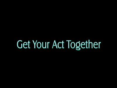

I just exported my HD movie to DVD (aspect HD) from PP2. When I played the disc on my 27" sony trinitron the titles looked all crappy! They were really fuzzy and flickery. None of my colors appeared to be unsafe for NTSC.
How do I ensure that my titles are going to look good on tv?
Even the Arial font in adobe's default White looked fuzzy. Interestingly the titles with a black outer stroke (type: edge, size 20.0) looked ok. Is this a problem due to the font or overly sharp edges or something else? I've attached a jpg of the titles as they should appear.
Any suggestions?

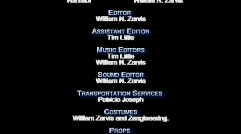

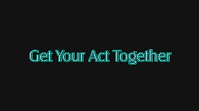

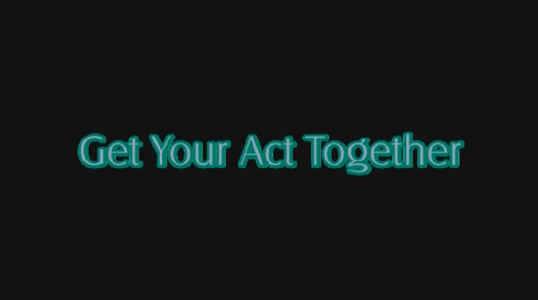

Here are two pictures of the crappy looking titles from the DVD itself. Apparently the titles are messed up even when I play the disc on my computer's 20" apple cinema display.
I've also noticed that the titles look bad when I export to wmv via adobe media encoder. Perhaps the problem lies with adobe's encoder(!)
In that case I better figure out a way to export my movie, encode it using some other program, and burn it to DVD using yet another program... Oy vey!
How to create NTSC safe titles??-gyat-title-dvd-.jpg   How to create NTSC safe titles??-gyat-end-credits-dvd-.jpg

When titles display on an interlaced tv screen, they must have certain attributes that will make them look good. You need to put a slight blur on the edges. That's why your black outline characters looked okay. Also, use simple sans serif fonts (which it appears you did). Make sure the horizontal elements of the characters are more than one pixel in height, otherwise they can disappear on alternating fields of an interlaced display. You should also make sure your vertical roll rate is an even multiple of 60.
Most of these suggestions are from Adam Wilt's site so you might wish to go there for additional information and background on why this is necessary.

Greg Thanks for those tips. The blur (starting from 0.0 and going to 20.0 points) acutally made it worse when I encoded a wmv! The titles, roll or not, all have the same problem... (Incidentally, how do I make sure my roll rate is a n even multiple of 60?)
At this point I actually think that this has something to do with adobe's encoder. The titles looks horrible on the DVD regardless of whether or not I play it on my tv or on my computer. If I export my movie to wmv I get the same problems.
I wonder if this has something to do with cineform's aspect hd or not. No idea yet.

Does your video footage look OK? The screenshot looks like it might if it were very heavily compressed - but that would affect the main footage as well...
Graham Hickling is offline   Reply With Quote
Old January 24th, 2007, 12:42 AM   #6
Location: Pittsfield, MA
Posts: 86
The video footage (from the DVD) looks ok on my TV but not on my computer monitor. It does however, look better than the titles.
I just imported an de-interlaced CFHD avi into TMPGenc and encoded it as a mpeg. That titles in that mpeg look good.
