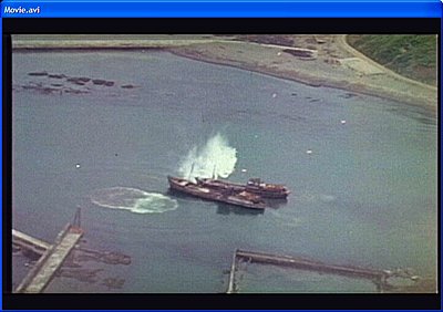

I have some old World War II color guncam footage that was transfered directly from 16mm film to dvcam. I brought the footage into Premiere and I am trying to restore the film as much as possible. I'm trying to work with levels and remove the haze or washed out look. See attachment for what it looks like straight from the tape.
Does anyone have any tips on the best filters or plugins to use for Premiere 1.5 and how I can restore some of this stuff? I know how I would do it in Photoshop, but I'm not sure if it's pretty much the same thing with the levels tool in Premiere? I tried it and it's not the same.

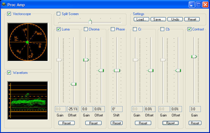

You can run the DV files through our Enosoft DV Processor and apply color correction.

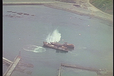

With a boost in contrast and a reduction in brightness, you can improve the appearance quite markedly.
Attached is an example along with the Proc Amp settings.
I converted the original sample jpeg to a 30-second DV AVI file. Color correction took 25 seconds on a 1.5GHz Pentium M (a single core processor) laptop.
