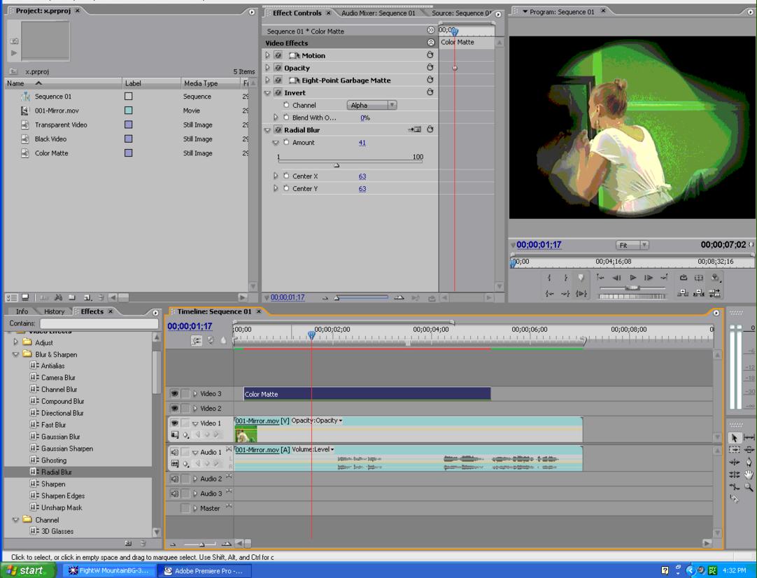

here's a screen cap, just because I wanted to try an attachment...
Andrew J Morin is offline   Reply With Quote

Wow. Even better. Thanks :)
You've just done all my work for me... heh
