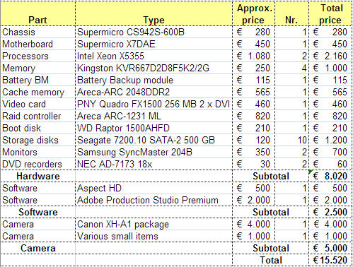

Recently someone asked what would be a nice investment for an editing PC, Adobe Production Studio and a camera package for less than $ 17K.
I came up with the following suggestion, based on Dutch prices including 19% VAT, so for the US you can probably just exchange € for $ and end up with the same numbers.
