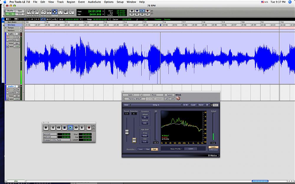

Thanks for the screen shot. So are you normalizing to RMS value to get the overall level up before you begin the the NR process? It is probably better than peak normalization since one spike can really throw they whole level off.
When you are sampling the noise how long is the sample? Typically I will use a fraction of a second.
I know what you mean about the difficulty of how much processing to use. The temptation in the process, at least for me, is to try to go too far in one pass. This creates the distortion or mechanical sound..
I am going to play around with mutiple passes and see if I can get close to your incredible results.
For fun I have included a Waves X-Noise screen shot.
Glenn Davidson is offline   Reply With Quote
A lot prettier than Sound Forge, but I think that's a Mac thing. Most Mac apps seem to have better looking UIs.
