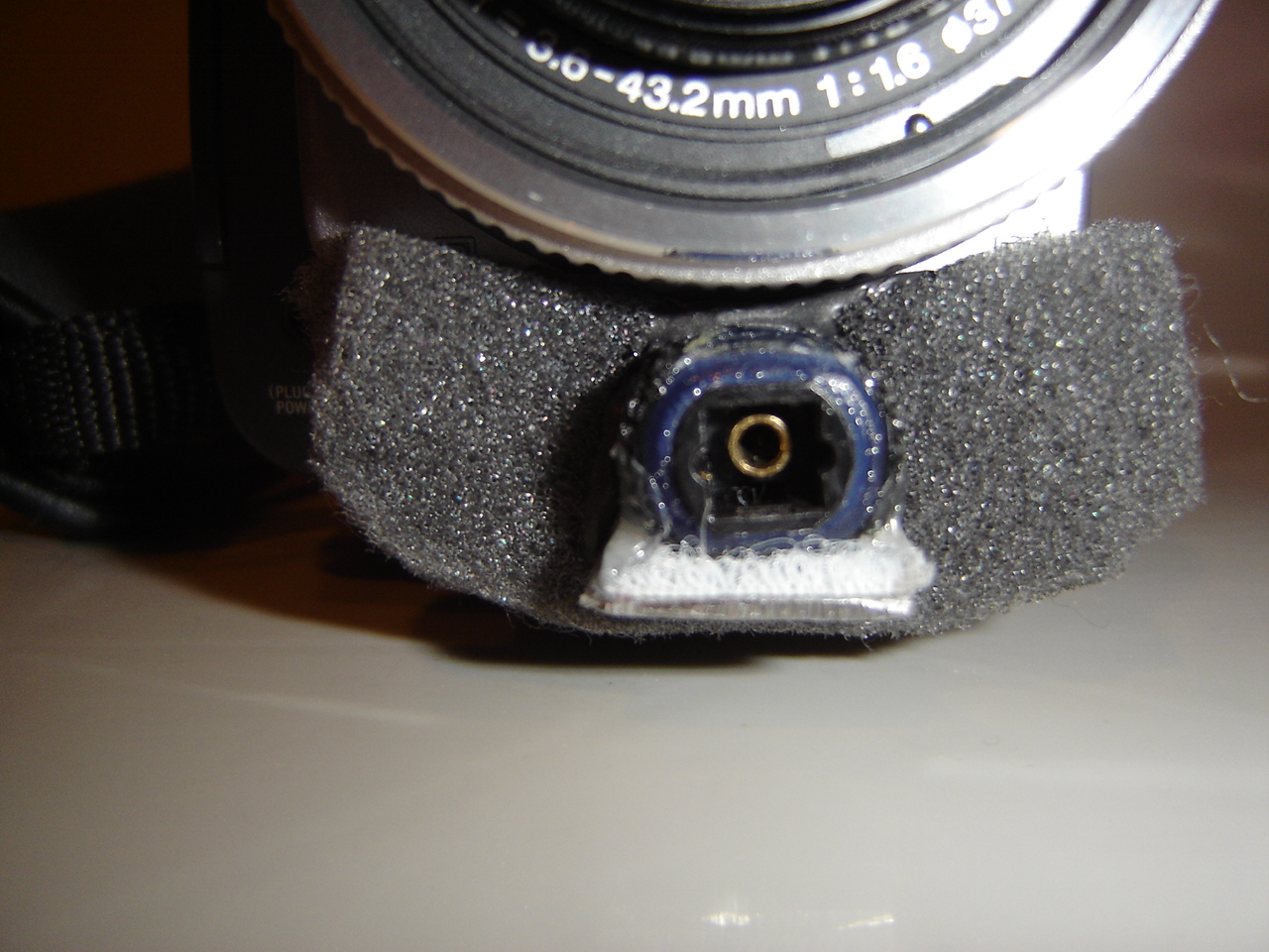

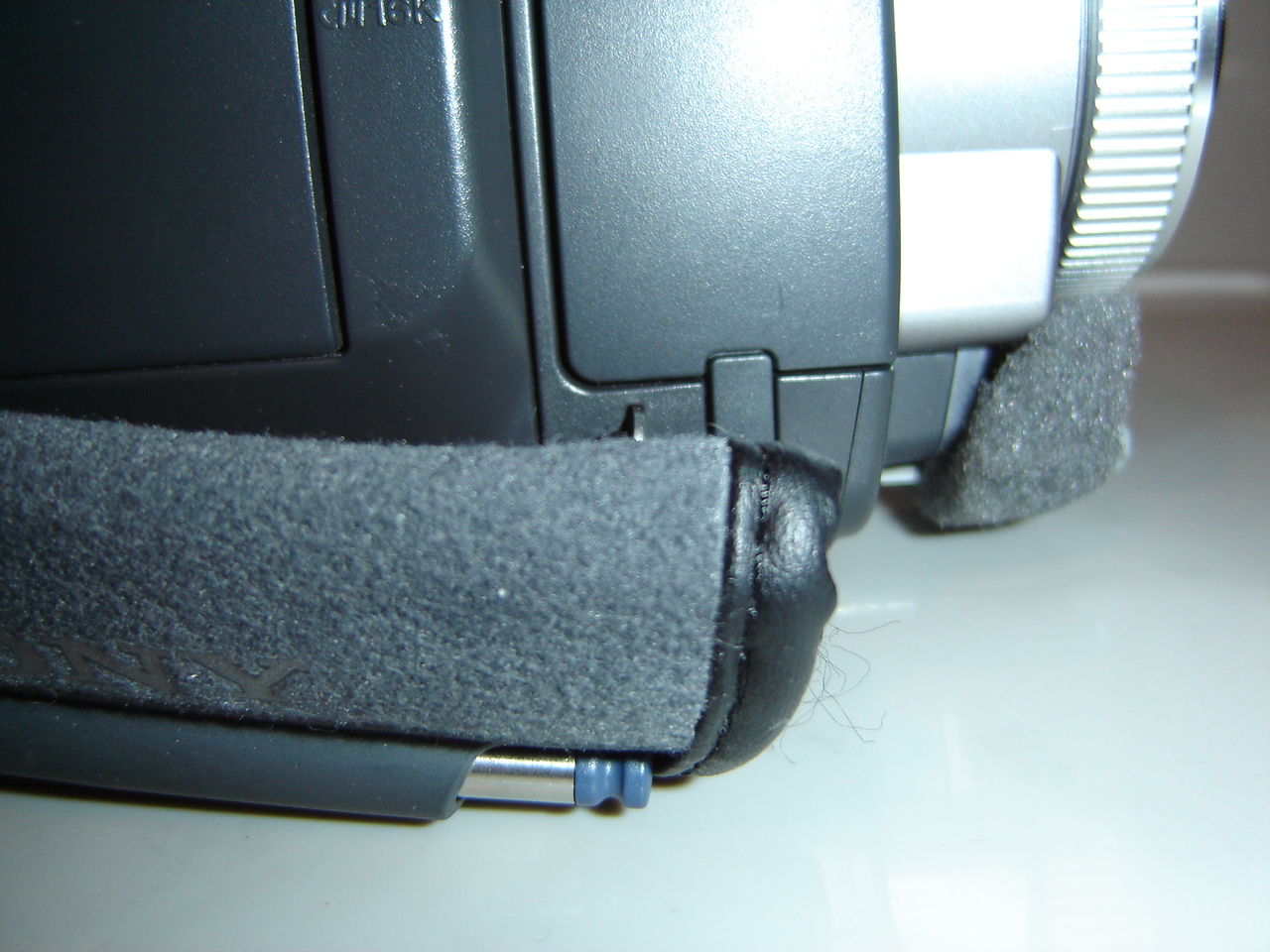

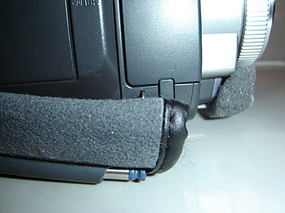

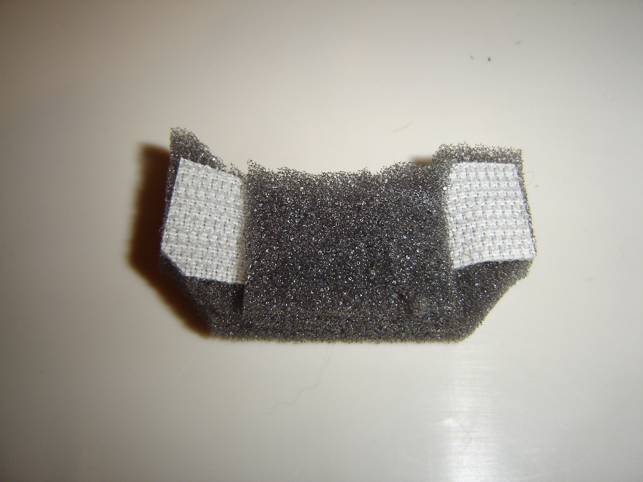

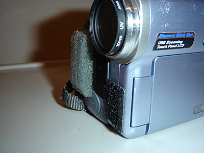

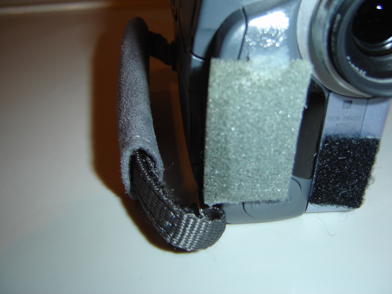

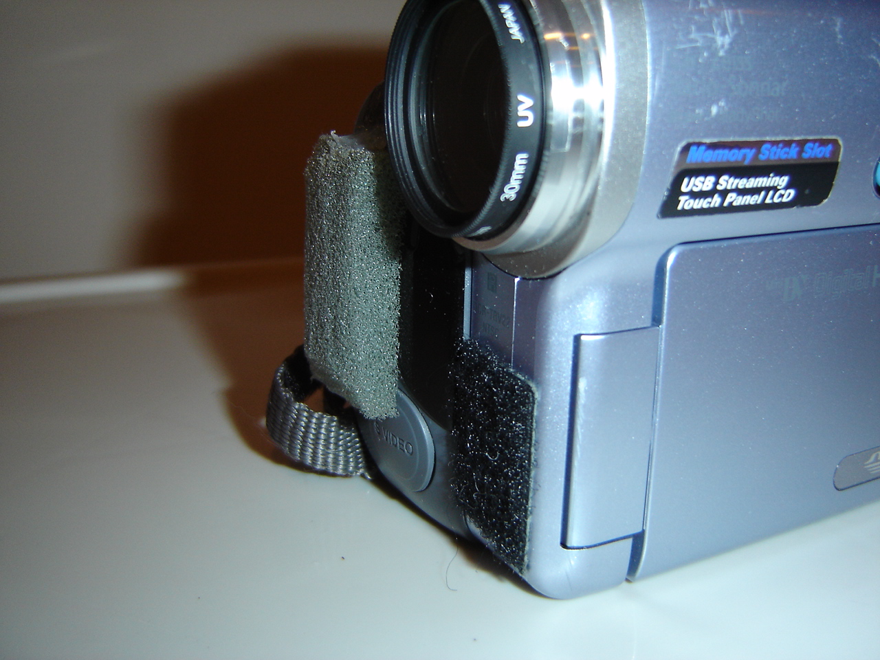

Hi Robert,
Here's what I've done for some of my cams.
Harold
block wind noise on built-in mics?-cam-mic-wind-difusers-001.jpg   block wind noise on built-in mics?-cam-mic-wind-difusers-003.jpg
block wind noise on built-in mics?-cam-mic-wind-difusers-005.jpg   block wind noise on built-in mics?-cam-mic-wind-difusers-006.jpg
Harold Schreiber is offline   Reply With Quote
