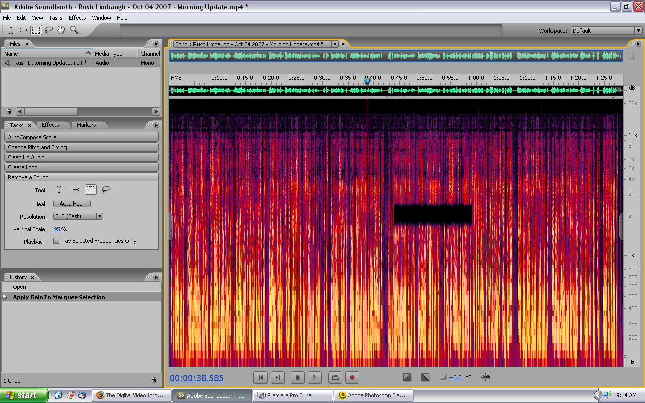

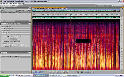

In sound booth you can bring the audio in and go into its vector form. You will be able to "see" the door slam. Then click "Remove a Sound." You then highlight the area of the door slam, and simply turn it down to nothing. That leaves the rest of the sound at that instant intact, expect if it is exactly the same pitch of course.

A screen print of a removal.
