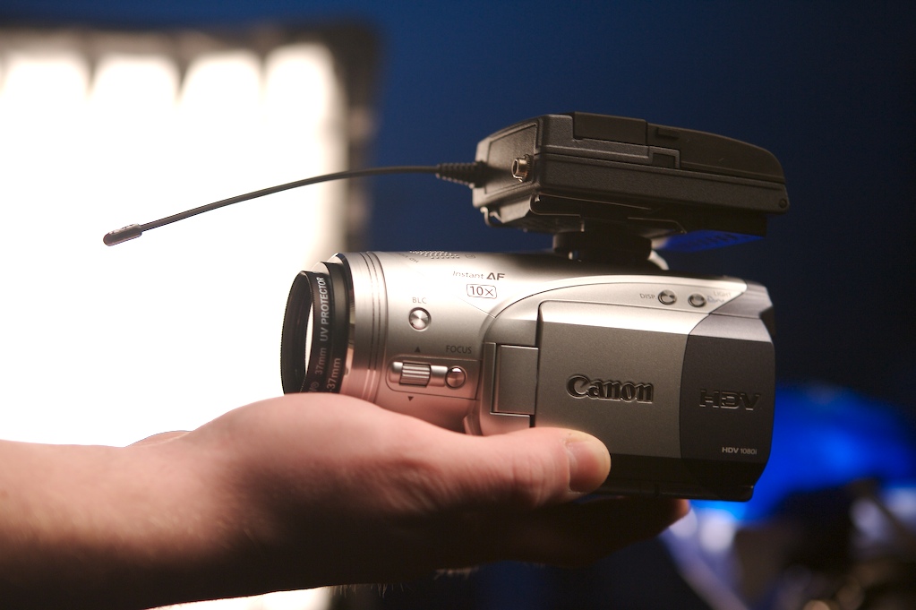

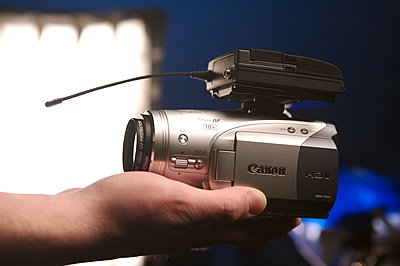

There should be very low hiss on an HV20 with the Sennheiser Evolution G2 wireless . Try watching this video to adjust your Transmitter and Receiver http://www.dvcreators.net/products/s...movieframe.htm
Here is a pic with the HV20 and the Receiver mounted. The antenna does not get into the frame at full wide. It's a good match in the $500 range.

What mic is that, I didn't get that big fuzzy with mine? Keep adjusting levels try turning up TX and turn down RX. But not clip/peak light.
Too much clothing noise. Crisp sound.
TX= transmitter
RX=receiver

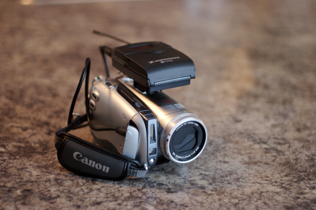

I watched your tutorial while doing research... in fact, that is what made me actually purchase the system, good stuff. I actually mounted my in reverse because the cord and antenna were getting in the way.

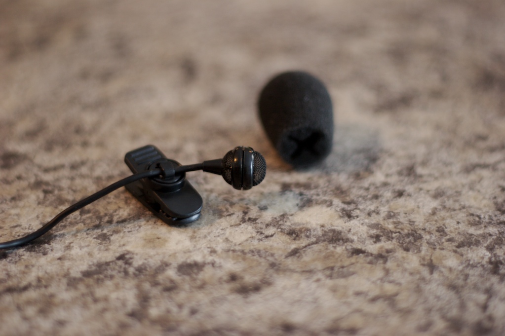

Brooks - it came with the ME4 mic, and yes, that foam piece is huge and the clip is very cheap. I don't know, I am very unimpressed with the actual mic. The transmitter/receiver seem very nicely made.
Again, I may being nit picking, but it just seems like there is a slight noise. And honestly, the audio quality isn't much better than my ATR35. With that being said, there is a ton less noise... which was the reason I got this in the first place. So, don't think I am bashing it or anything. I just thought for 500.00, they could have included a better mic.
So the new question, would I really benefit from lets say a Tram TR50SQ upgrade? I'm just wondering if there would be a noticeable difference, because it is 230 bucks... and if its just slightly better, I don't really want to waist the money.
My whole goal is to have the least amount of post audio process, so I am hoping better equipment can assist.
Thanks for all the responses.
Scott
