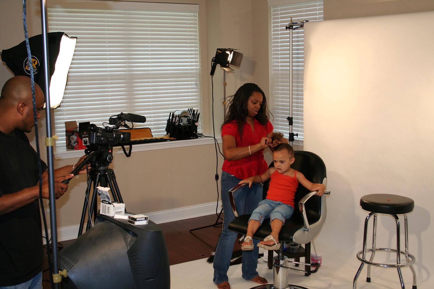

I've attached a picture of our environment. It's a square room, cherry wood floors, 9 foot smooth ceilings, about 350-375 sf.
I don't care about cost, I just want the best and I want to make sure to make a good investment in something that I really like. We really haven't found that sweet spot.
And after watching Ty's video, his boom mic's sounded so good I'm really considering changing.
But Ty, you also mentioned the Countryman e6, that also sounded good on your video. I'm kinda torn...

Hey Ricky,
Thanks for the shot.
Countryman makes the e6 in a dark tan as well; that'll help it disappear into her skin tone.
Even though the mic is an omni, because it's so close to the mouth, you hear a lot less room.
