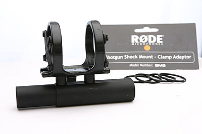

There is a Shotgun Shock Mount for the Z1U that will help push the mic up higher. It's called the RODE SM5.
It's also threaded for 3/8" and 1/4"-20 if you ever wanted to use it at the end of a boom pole. http://dvcreators.net/rode-sm5-shockmount/
