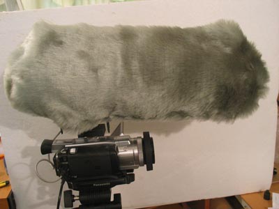

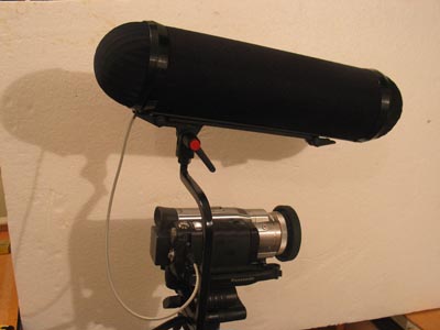

Check out the blimp out of the Punjab in India. I just received mine and it is pretty well made. See the following ebay link which is what I got. They are selling all the time on ebay. I got it for a Rode ntg-2 and it fits fine on the short length.
http://cgi.ebay.co.uk/Long-Blimp-Win...742.m153.l1262

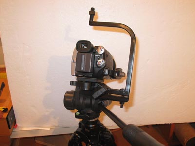

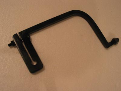

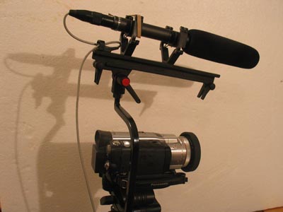

I've made an adapter to go on my tripod to keep it all separate from the camera. See photos.
The photo with the furry was taken before I made the adapter but it shows you what it is like.
The kit comes with a 160mm extension to the blimp, two extra end cap, and an extra frruy for the long length.
Renton Maclachlan is offline   Reply With Quote

I don't see any reason at all why the shock mount should not work. Shock mounting is an emminently simply system - suspend your mic on rubber rings. This does that in precisely the same way any other system does it.
I don't see any reason why this model should be understood to be weak and need to be 'taped and glued' etc. The cage and end caps are continuous plastic grid and the fine material that fits snug over the grid is securely fitted.
Obviously the unit is built for lightness - who wants to hang a heavy blimp on the end of a boom pole and hold it up all day? But that would apply to any blimp I imagine.
Also obviously you wouldn't want to use it as a foot ball and chuck it around. But would you do that to any blimp?
The Rycote one looks like it uses very similar sort of plastic grid - so wouldn't be any stronger, only it has the material on the inside as opposed to the outside. See.
http://www.rycote.com/products/full_...em/windshield/
But the Rycote equivilent to what I got costs $us700 plus shipping which would be another $us50 probably, whereas I paid $us166 delivered! ($nz950 verses $nz211).
Frankly there is no comparison! The only thing I'm missing is a carry case, which I will have to make to protect it.

Renton, that final shot was hilarious! The blimp is about 20x the size of your camera. :)
