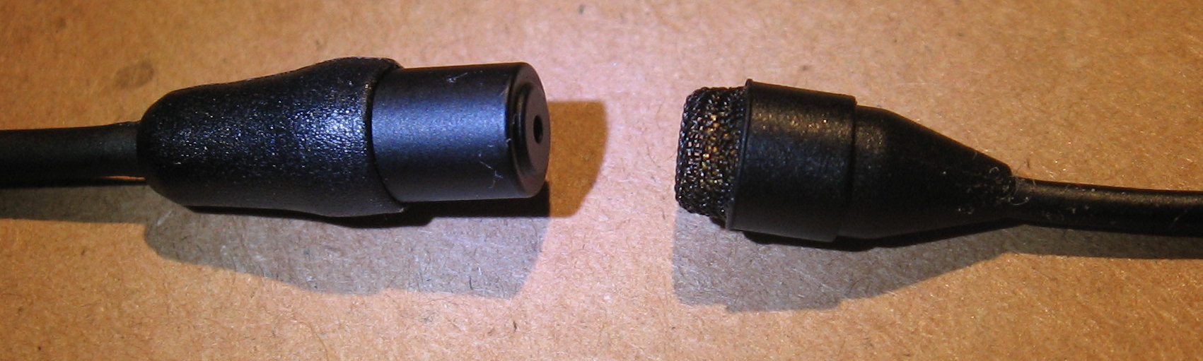

I got it in the IMK4061 kit, aimed towards miking instruments. I got more with that that was listed in the contents from DPA's site. Specifically I wasn't expecting the belt clip version of the microdot-XLR (P48) adaptor, or the vampire clip mount. Actually, the belt clip is optional, you can unscrew the adaptor and pop it off. It's not comfortably to wear, as the angle of the clip digs in a bit. I first tried it out on the wired connection, and for some reason was whispering...and it caught it so cleanly. This was doubly pleasing, as I had been a bit worried about this "reduced sensitivity" compared with the DPA 4060, and now I know it simply isn't necessary for me. Slightly disappointed I did not get the high-boost cap with it, I think that might have application for mounting under wardrobe. You can't get them singly, only in packs of five, and that's £47! Compared with the AT899, it's a bit smaller, the cable is thinner and more flexible.

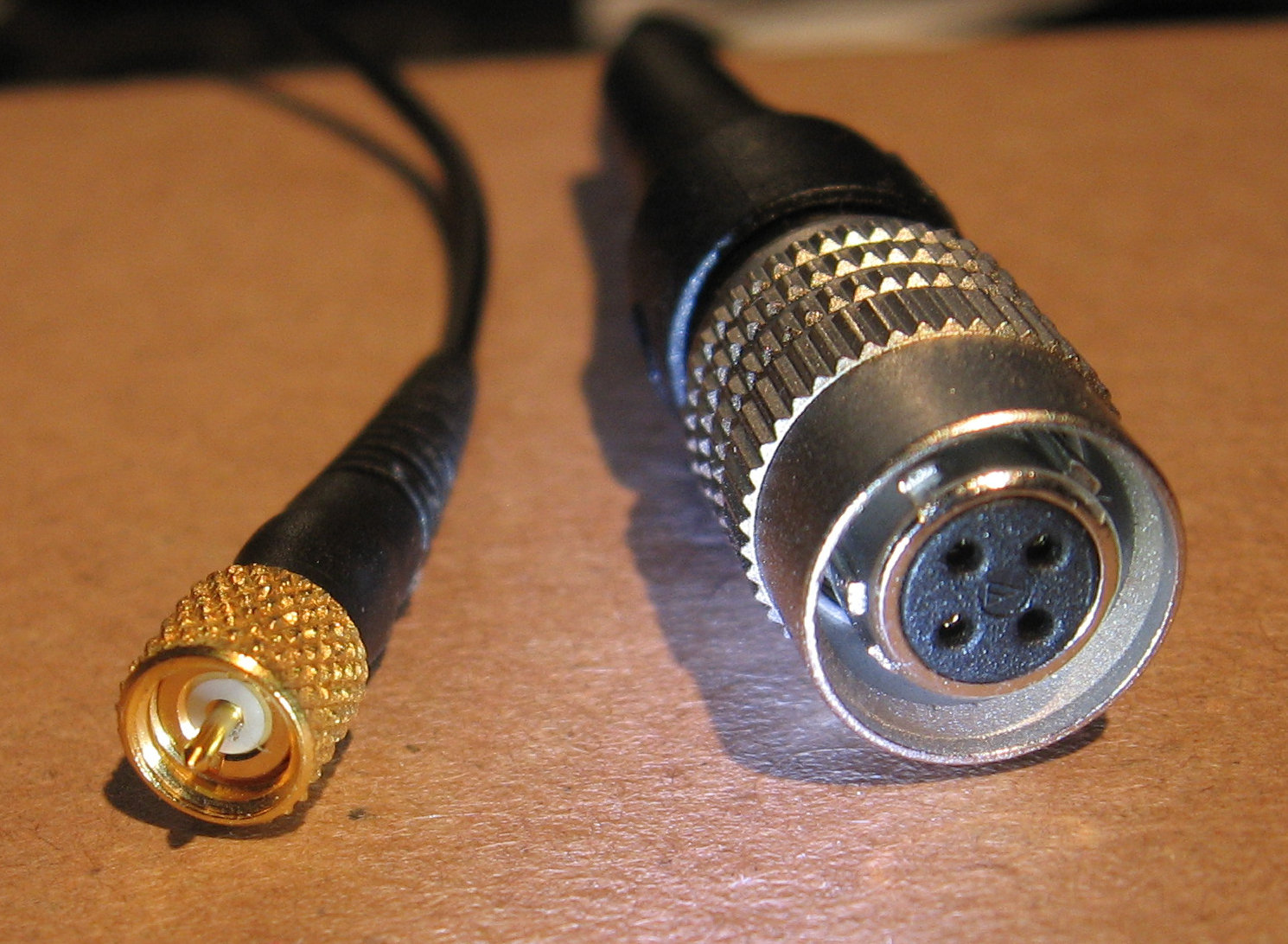

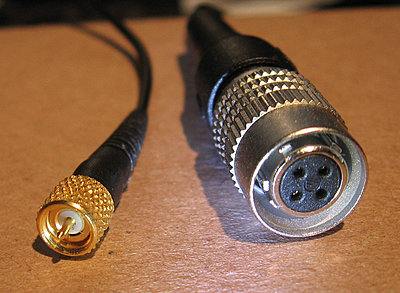

In the photos, the pic of the mics has the AT on the left, without the element cover, and the DPA on the right, with the soft-boost cover. The photo showing the connectors has the DPA's microdot connector on the left, and the hirose spring-locking 4 pin connector on the right.
