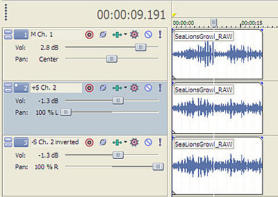

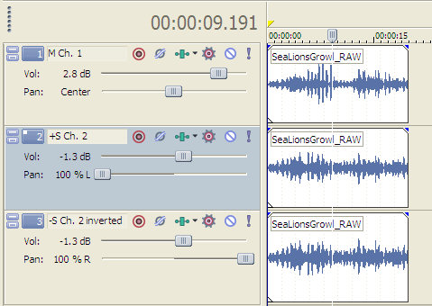

These are an M and S recording - M a long shotgun on ch. 1, S on Ch. 2? Straight recording with no processing?
I couldn't get them to decode properly to create a stereo image. I did have some fun setting up a decode with -S and +S delayed by .002 seconds.
I'm not too sure of the applicability of a long shotgun as a Mid mic. It makes pretty heavy use of phase differences to create directionality - and phase differences are essential to the M+S encode/decode.
Do you have access to a cardoid mic you could use for the M signal? That's the classic approach.
To decode an M+S recording (and you do need to decode it to create stereo):
The M signal is your cardoid (or shotgun, in your case). As a convention, record that to Ch. 1. The S signal is the bidirectional mic (MKH30), record that to Ch. 2.
Bring the recording into your editor, and ungroup the channels so you can work on them independently. Copy Ch. 2 and invert the phase.
You now have:
Track 1 - Ch. 1 - mid
Track 2 - Ch. 2 - side
Track 3 - Ch. 2 - inverted side
Pan Track 2 hard left, pan track 3 hard right, adjust the volume of Ch. 1 up and down - you should be hearing beautiful stereo. Wider image with Ch. 1 lower, narrower image with Ch. 1 higher.
The math used to describe this phase relationship:
L = M+S
R = M-S
When I used a stereo widening effect in the samples above, I sort of recreated the MS decode.

I've posted a straight MS decode of the raw wav file, nothing else done to it, now we've got some nice stereo!!!
Have a look at the track layout below. It's all I did to do the decode. It would probably be improved by some eq & compression, as in yesterday's samples.
