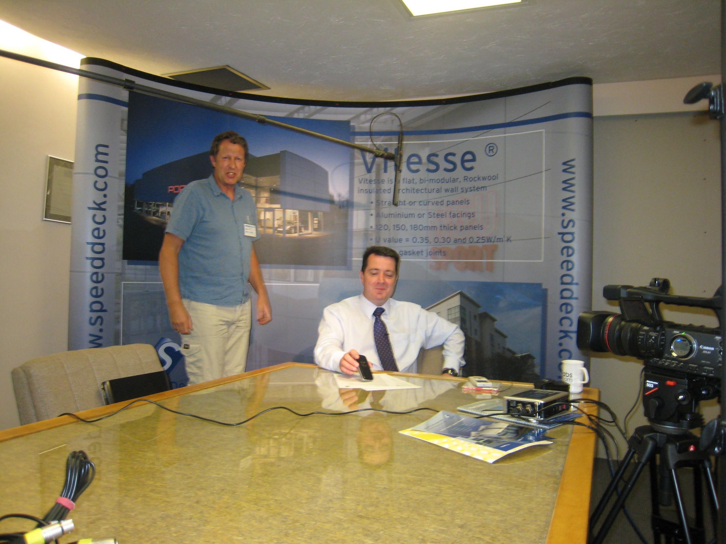

You can see the 4061 clipped onto the tie. The Sanken is on a fixed boom overhead. Both are going into a Fostex FR2 LE via a Sound Devices 302 mixer.
I've been back to the supplier who tested the mic and said it's fine as far as he can tell.

Photo of Sanken placement enclosed in case you have any suggestions.

another note, the shotgun doesn't have a screen on it. having a windscreen on it would of dulled it slightly... and you should have a screen on it since HVAC systems can really push air around quite a bit in some buildings.

Glad to help Richard. From your photo it appears that the DPA started out farther up on the tie and the cable was dressed correctly. Did the mic slip down before you shot the video? It does appear that you have enough room to get the mic in a bit closer. If you can listen to the placement as the talent rehearses it gives you a chance to try a few different positions and get one that makes the most sense for the mic/talent combination. I've tried aiming while sitting in for the talent and once the real person comes in I end up moving it anyway. Eyeballing it gets you close, but listening is the way to really find the best sounding position.

Bernie - you attention to detail is better than mine. Of course, the talent had to get up a few times and I let him put the mic back onto his tie! And he probably moved it. I will watch out for that in future.
